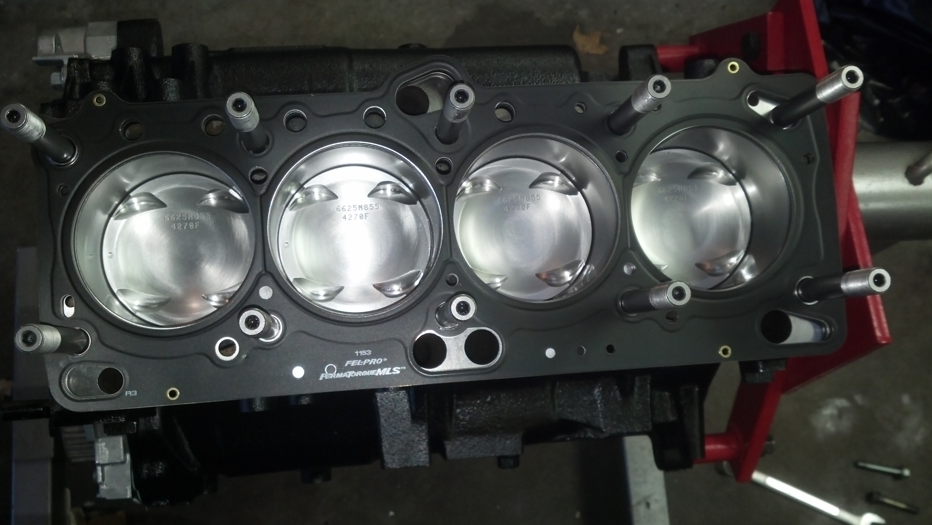

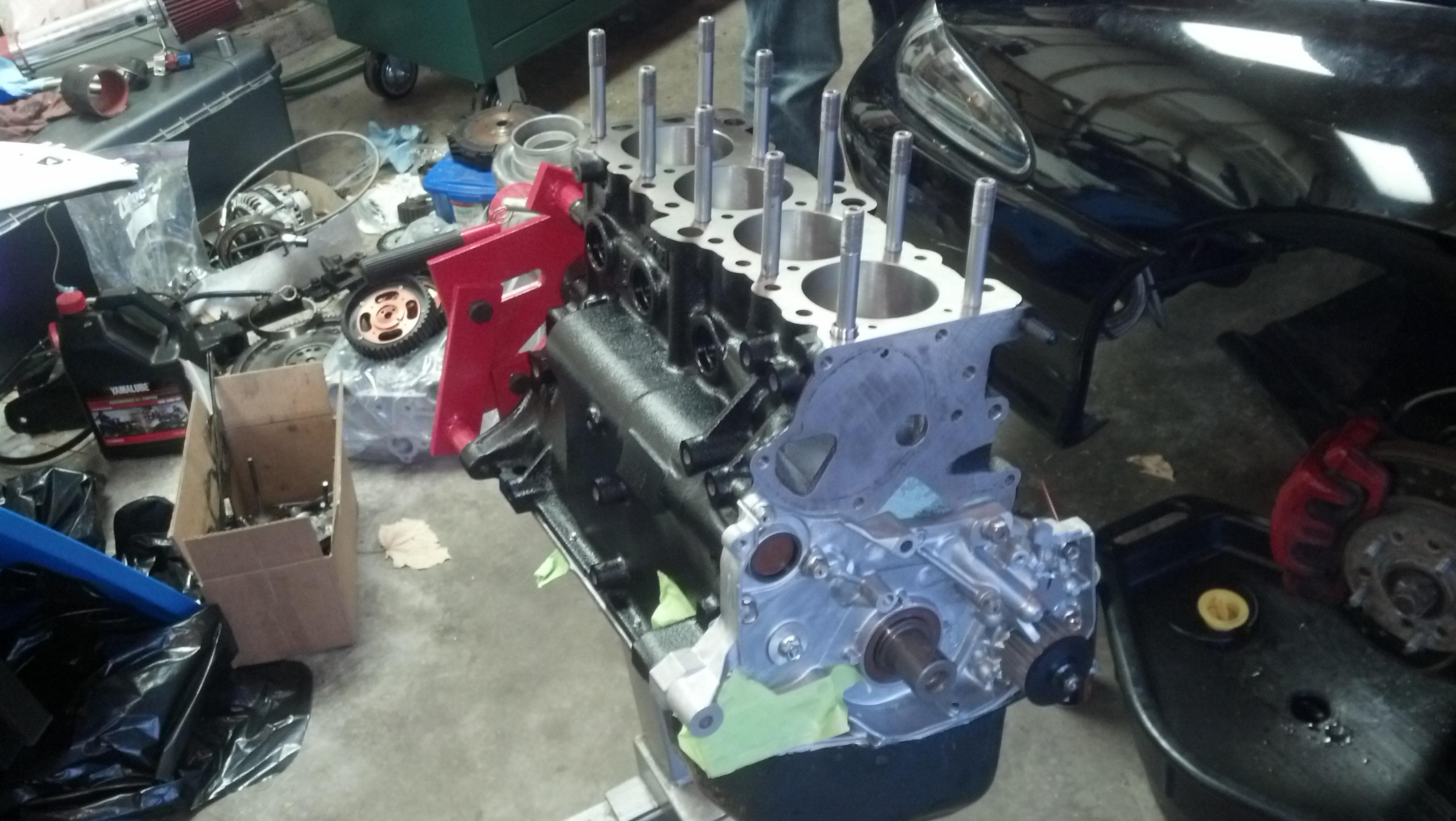

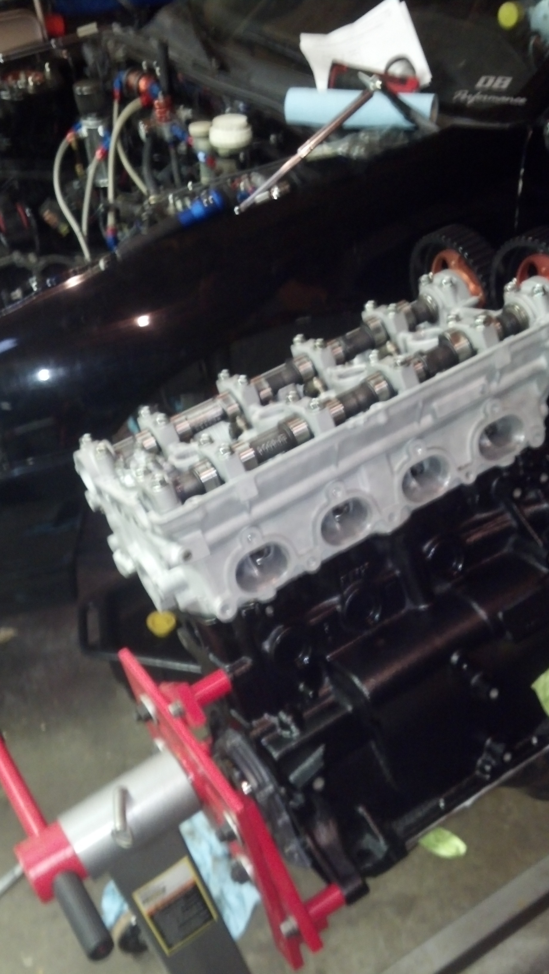

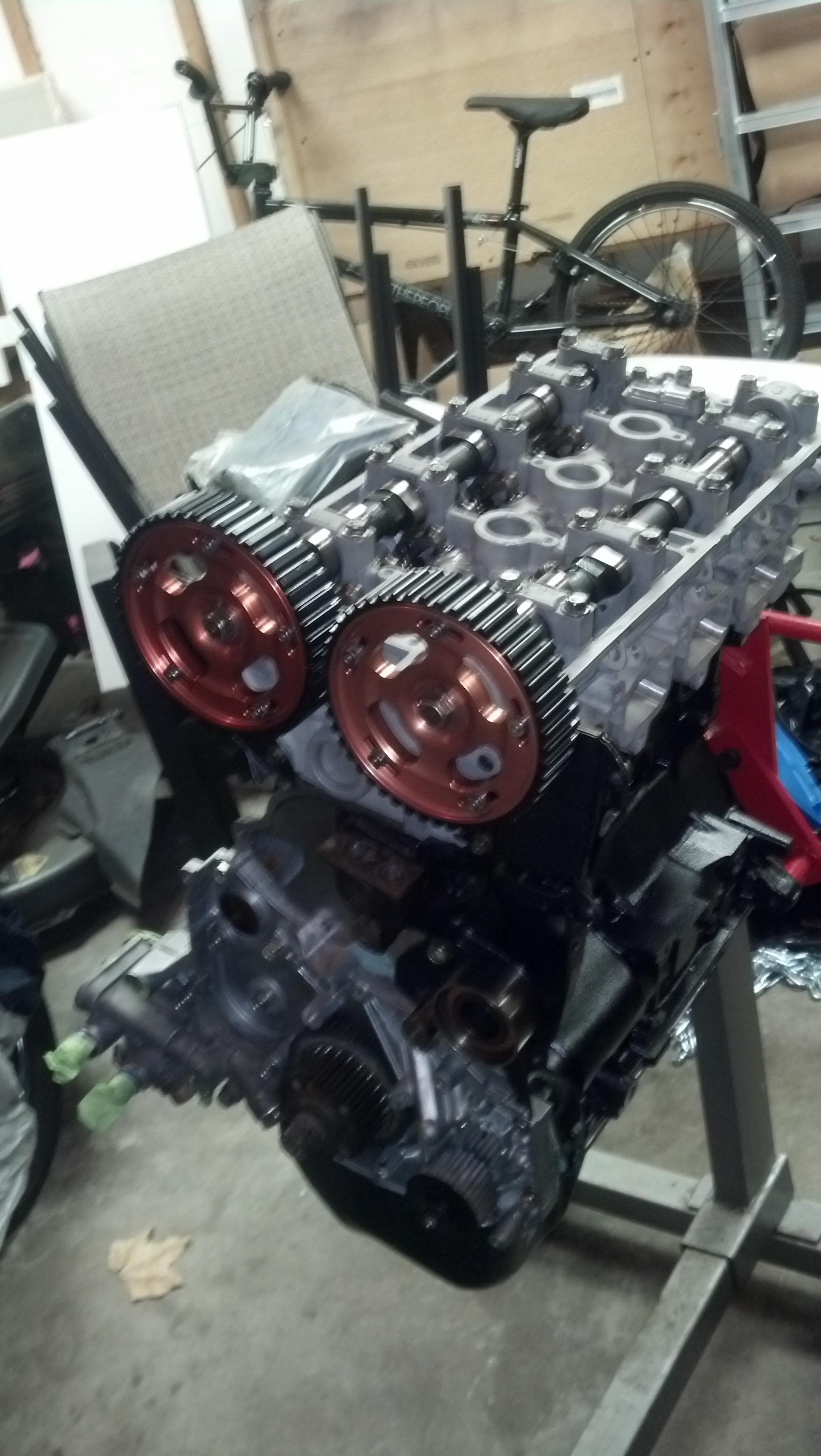

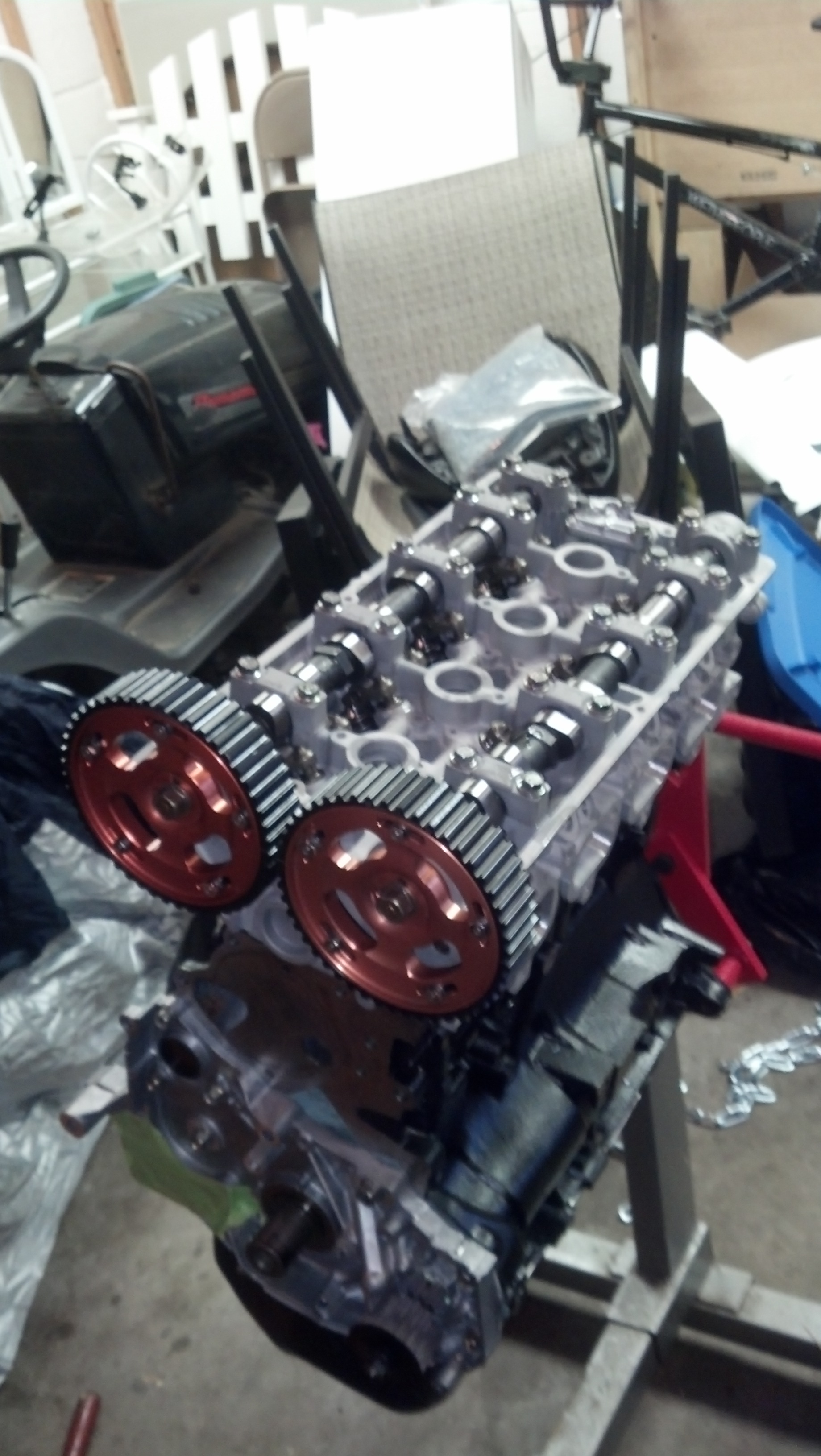

Well I got a little work done today.
ID:	13149   Click image for larger version
ID:	13150   Click image for larger version
Old 12-02-2012   #48
4seasons69
4seasons69's Avatar
Location: Circle Pines
Posts: 2,048
Re: my new project

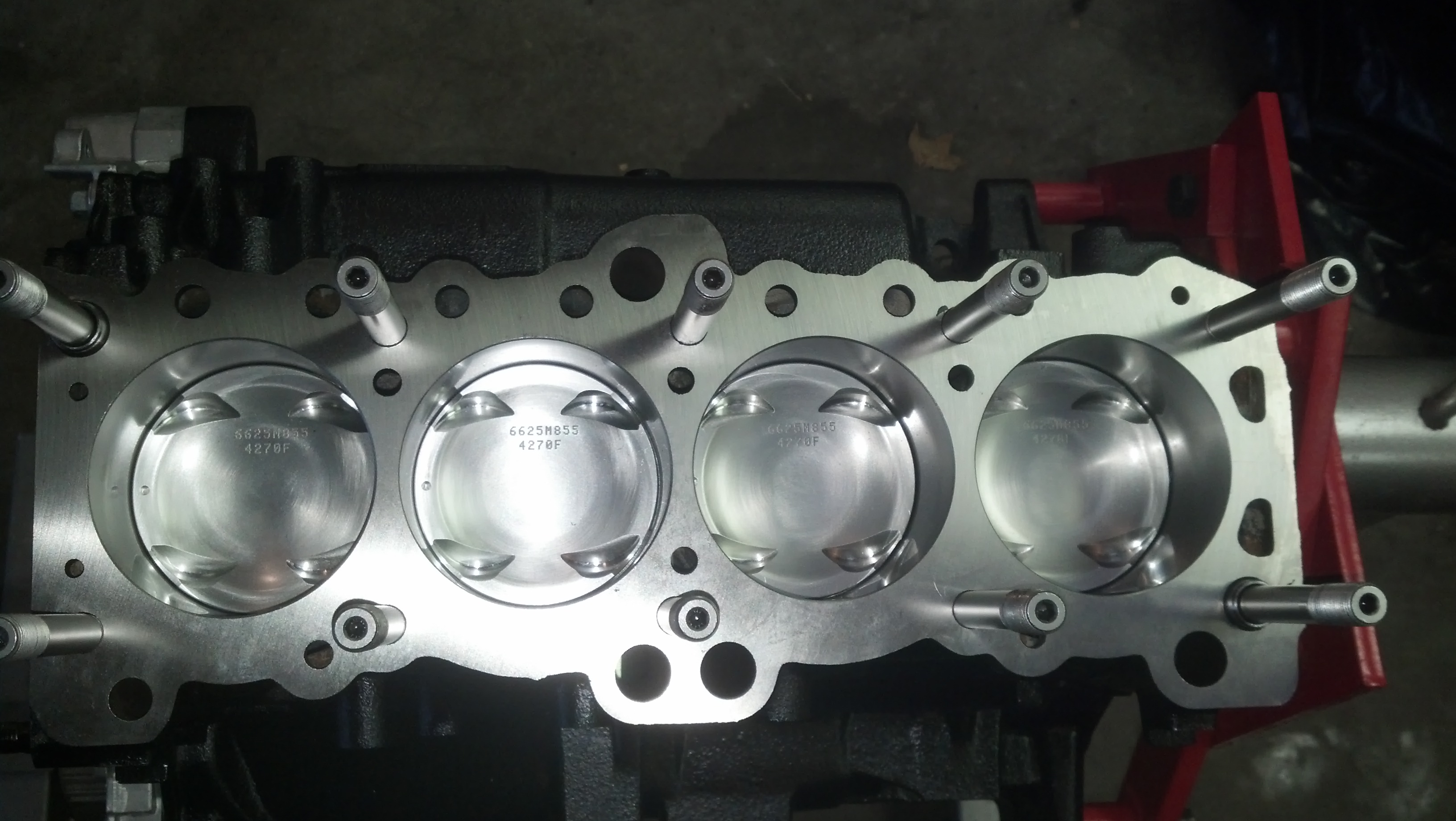

Some more pics

Old 12-03-2012   #49
4seasons69
4seasons69's Avatar
Posts: 2,048
Re: my new project

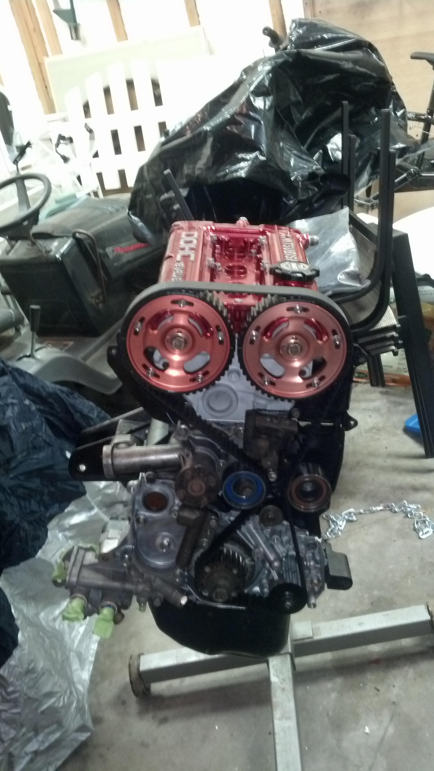

Well I got the long block assembled and ready to have the cams degreed. Now I just need the cams degreed, clutch rebuild kit and an upgraded clutch fork and the engine can go back in finally.

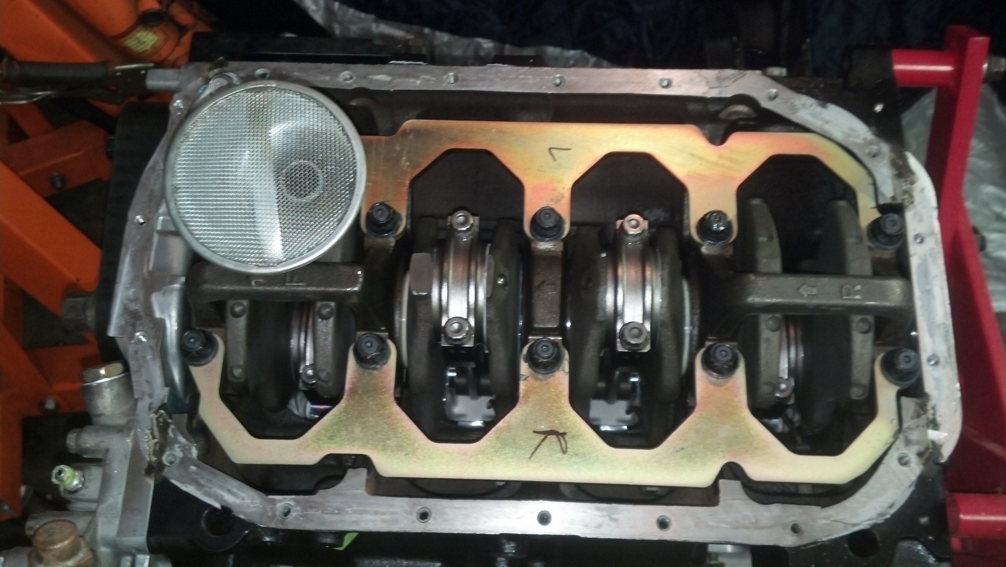

Also when I was going through my parts I found my oil pick up tube but map had already put on my oil pan. I figured map probably installed a new one but for my own peace of mind I pulled the oil pan and of course they did but I snapped a picture of the main girdle

Old 12-03-2012   #50
Re: my new project
That's a pretty shortblock
Old 12-03-2012   #51
4seasons69
4seasons69's Avatar
Posts: 2,048
Re: my new project
Thanks! It sure is!
Old 12-03-2012   #52
Re: my new project
Looks awesome. Looks like its on its way to be ready come spring!
