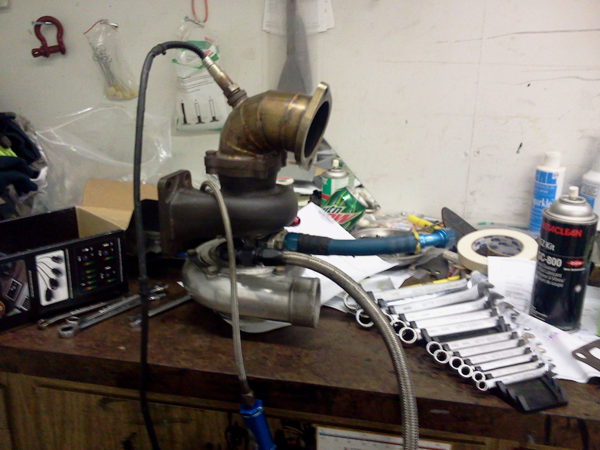

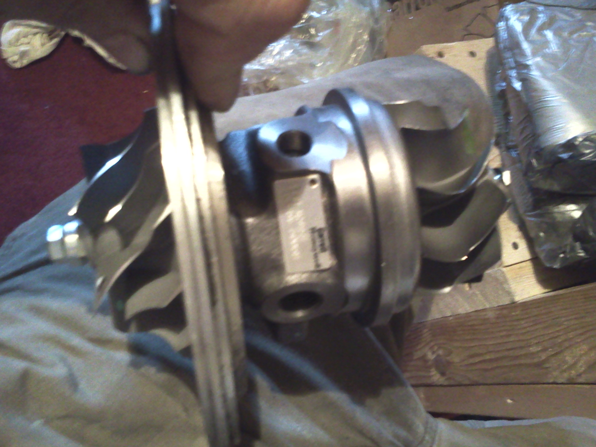

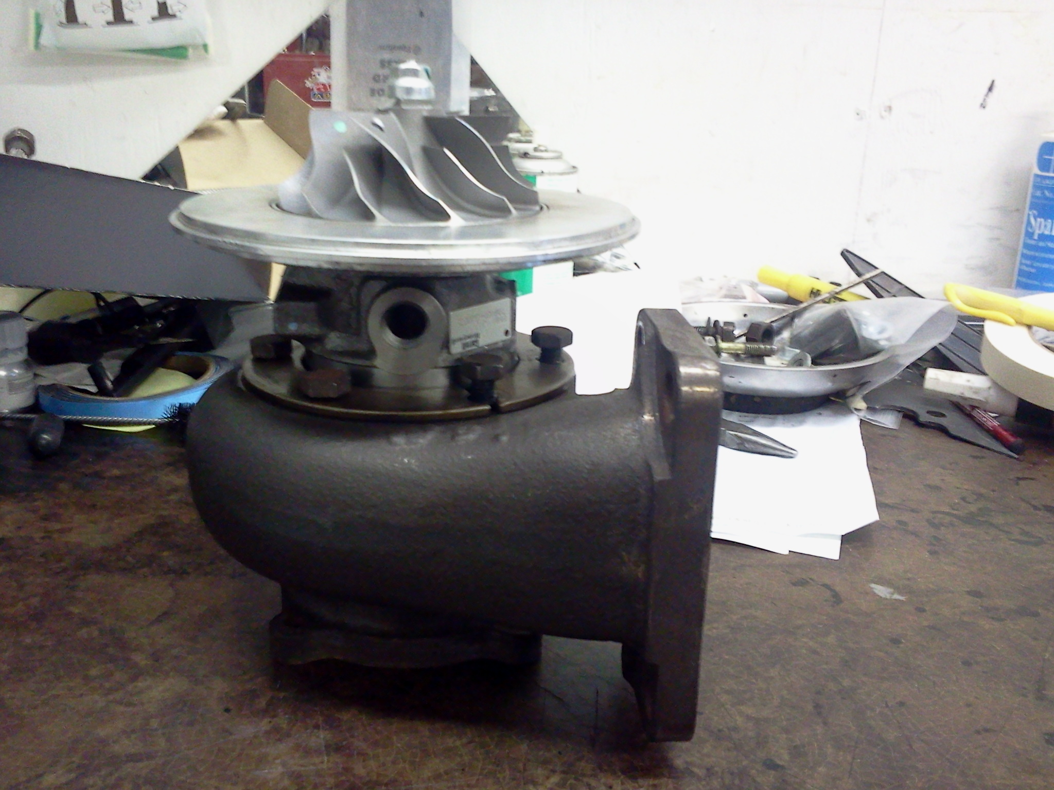

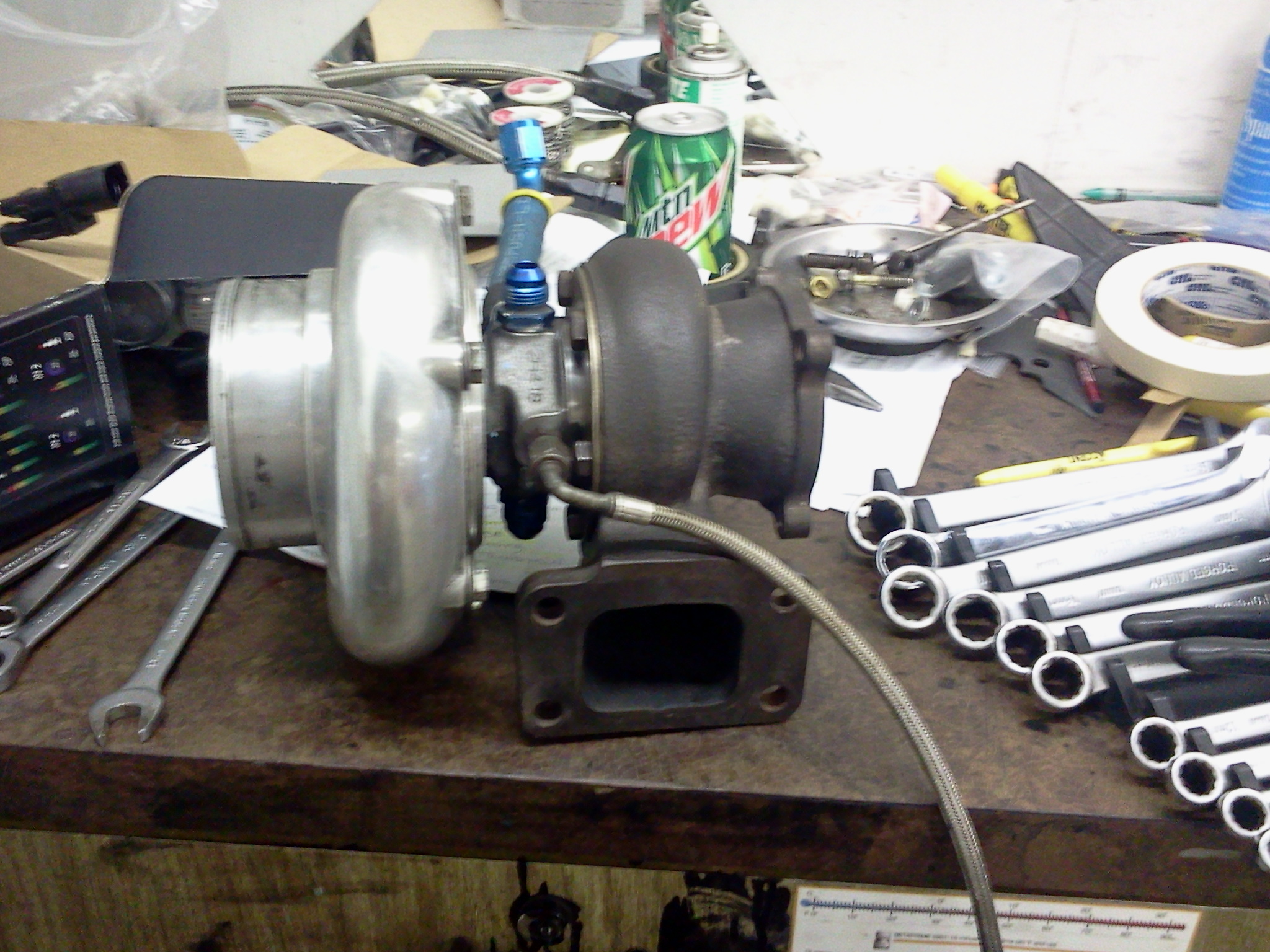

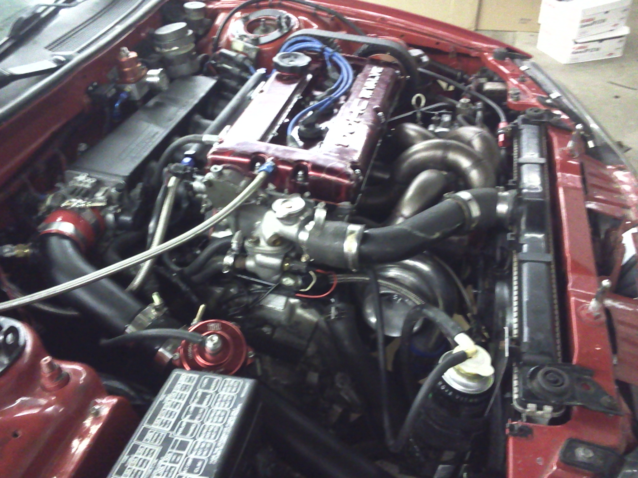

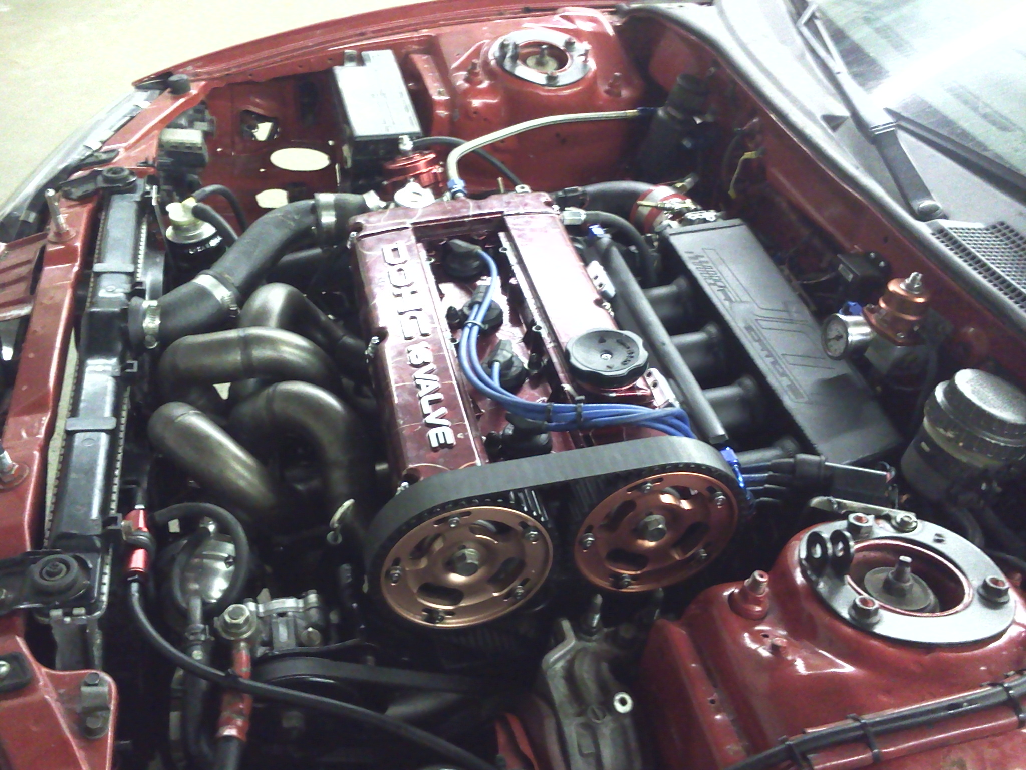

ok i had the sensor turned the wrong way so it should start. here are some turbo pics

That's a hell of a nice setup you've got there

turbotalon lol you are messed up. its my new stock appearing secret turbo. jk its my new chra gt3582r...
