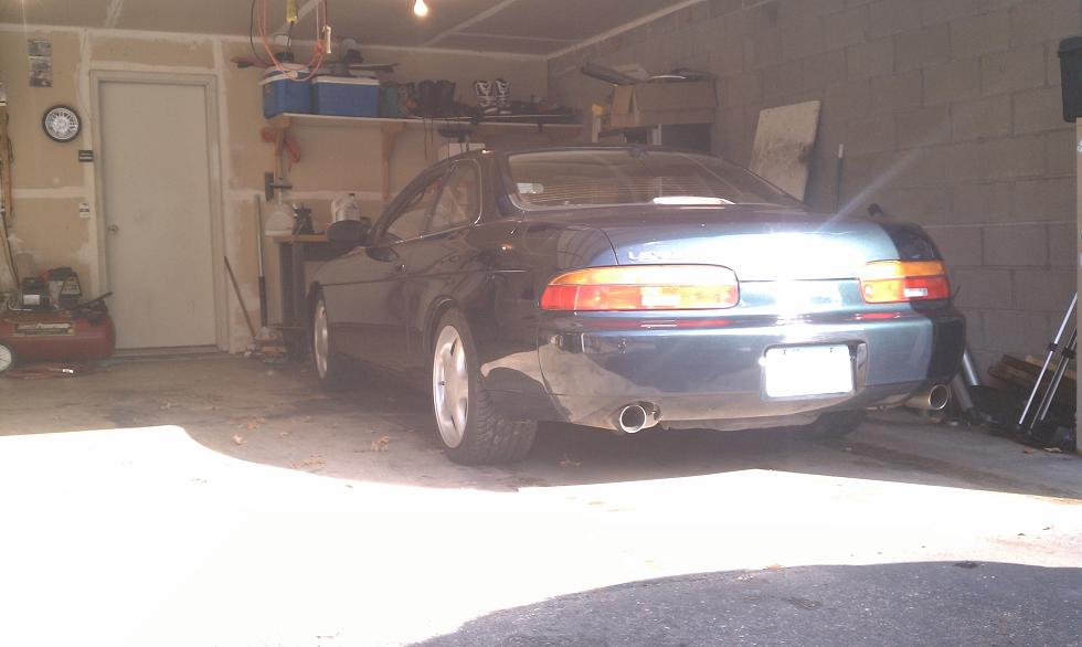

No big update, but she's officially back home and out of storage. Going to do an oil change and start driving her around when it's nice out. No plans for any more mods at this point as my hands are already full with wedding planning and the new house.
