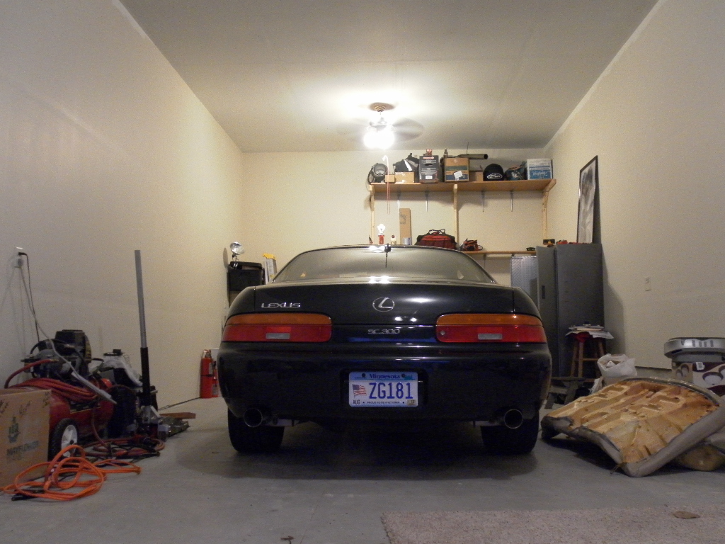

Was bored last night so decided to install the 2nd 255hp. Everything appears to be working fine, and fits great. The Y that I bought, not really liking it because my hoses had to go all loopy just to ensure no kinks. So will probably rework it this winter.
Also went over to Kerry's today to swap springs with him. Suspension is now stock Supra springs all around, with some new Bilstein shocks. It's known as an excellent poor mans suspension setup for an SC. Car sits a little higher than it used to now (had eibachs before), but about 1" lower than stock. Should be perfect once I get some side skirts and lips put on the bumpers. Also leaves room for some more rubber. Car feels like a "Lexus" now with this suspension, I'm loving it so far. The old shocks were trash.

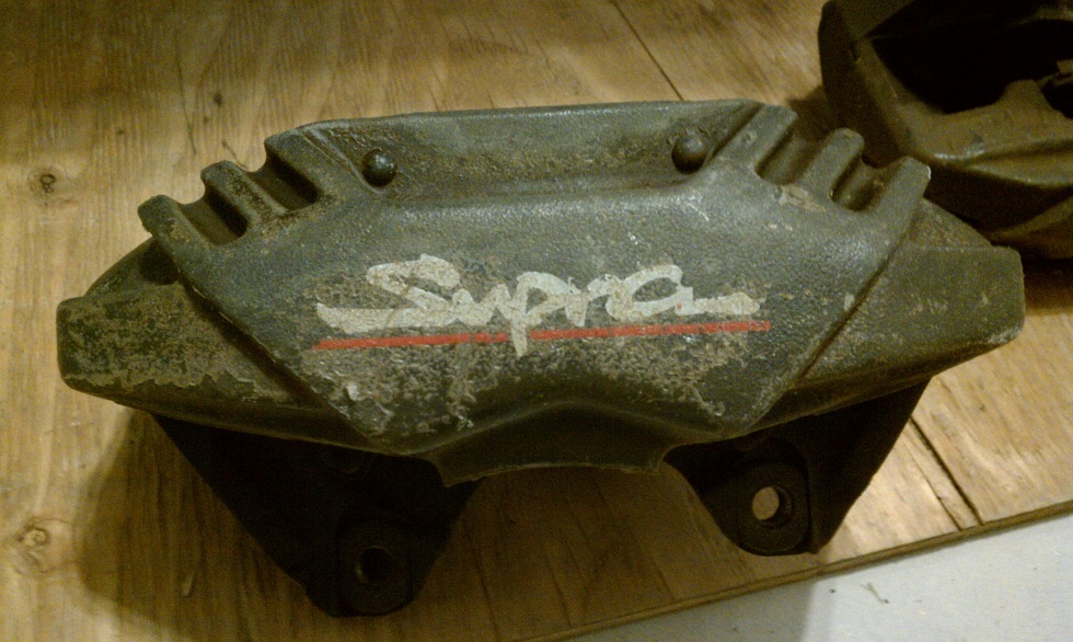

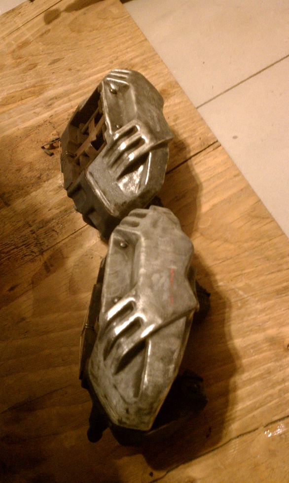

Decided to clean up the front calipers.
Before, during. and after pics attached. Although I haven't applied the clear yet, will do that tomorrow.

Old 09-07-2012   #618
GsXtUrBo98
GsXtUrBo98's Avatar
Join Date: Nov 2007
Location: lino lakes
Drives: 98 GSX, 04 is300
Posts: 1,856
Re: Project Lex
Looking good!
98 GSX (built)
03 BBY EVO dd
GSX 463awhp 363awtq on DB!
Old 09-07-2012   #619
Re: Project Lex
Sweet!
Old 09-07-2012   #620
Re: Project Lex
Those calipers look awesome!
