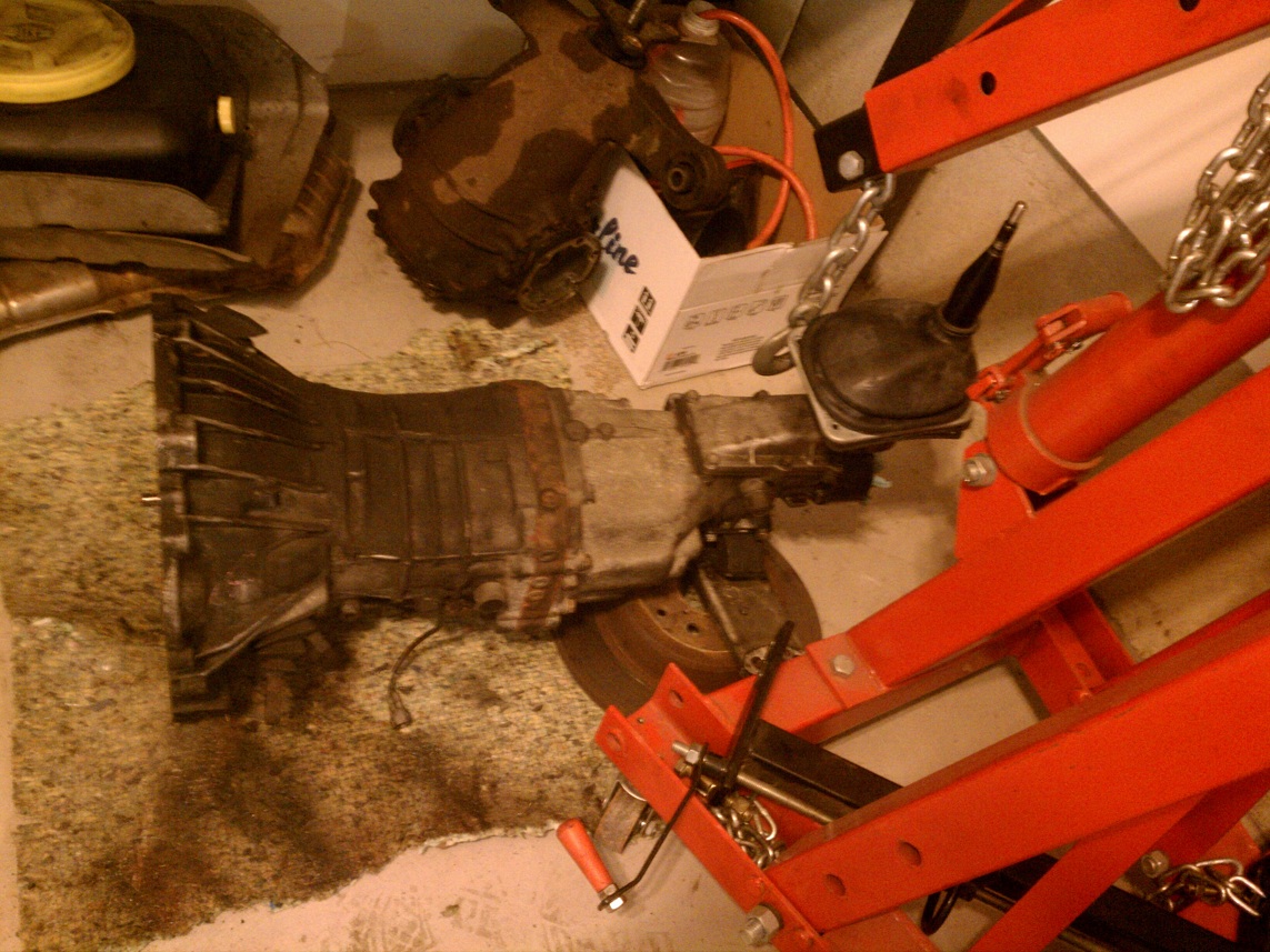

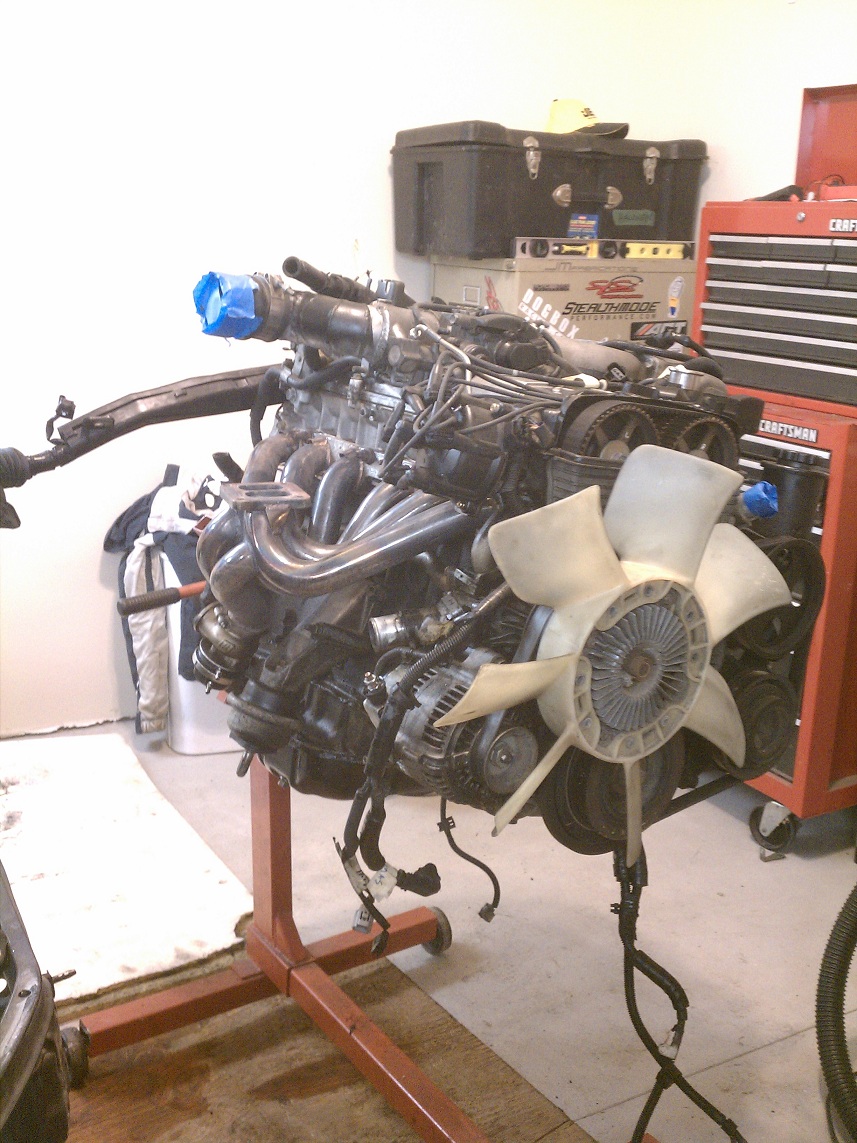

Trans off, motor on the stand. That's how she'll remain until we come back!

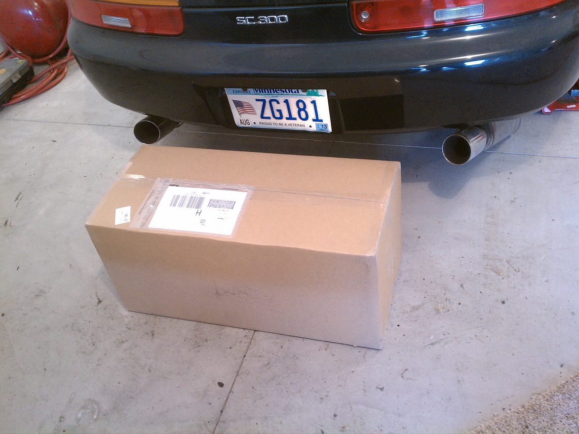

Got home and had a couple packages waiting for me.
Engine gasket kit:
Billet shortenen shifter bracket, to move the shifter more forward to better place the shifter. The shifter will still end up a few inches more back than the stock one was, but this is as short as it can get. So might have to modify the hole in the tunnel, as well as figure out what I'm going to do with the interior trim.
Also looks like my new clutch was attempted to be delivered but they delivered it requiring a signature and I've been on my honeymoon So hopefully it's still sitting at FedEx tomorrow and I can go get it.
And my Rideskinz rear bumper lip is supposed to ship out tomorrow as well

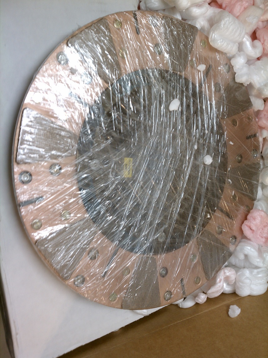

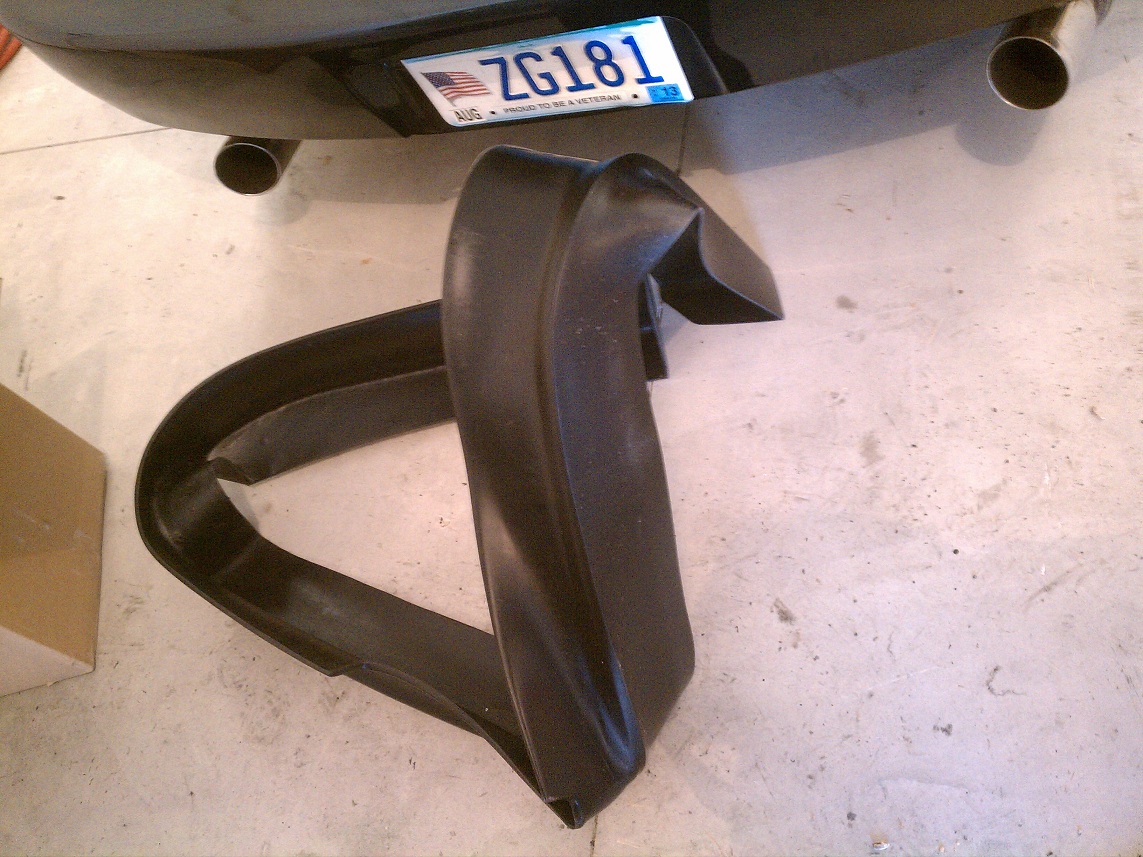

Received the correct clutch disc today, finally...

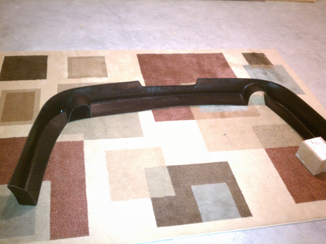

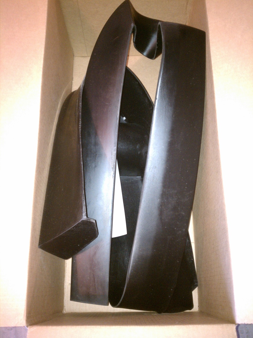

Also received my new poly rear bumper lip today from Rideskinz. What do ya guys think?

Old 01-18-2013   #774
Re: Project Lex
WTF at that lip lmfao! Are they serious???? This time ebay has failed you. haha
Old 01-18-2013   #775
Re: Project Lex
Hahaha, I seriously can't help but laugh right now!
It wasn't ebay, it was a vendor over on Club Lexus who makes these and is doing a group buy. Needless to say, he has an email in his inbox

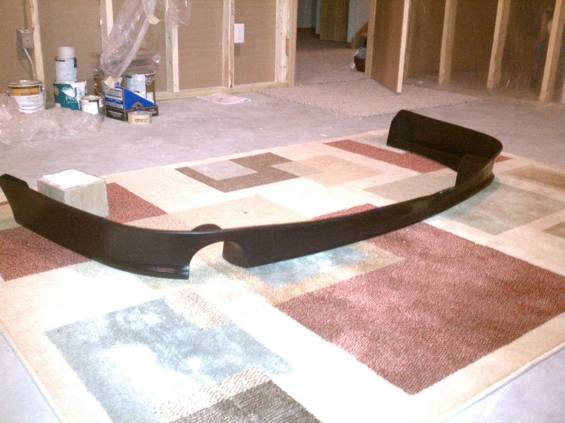

Re: Project Lex

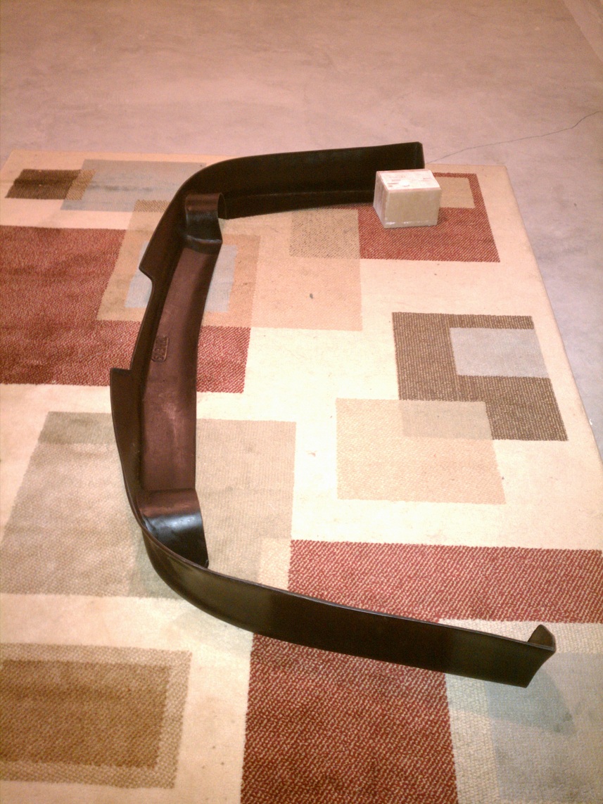

I have it sitting in the house now. Looks like now that it's warming up it's starting to flatten out. Still has a little unwanted curvature but might end up being ok.

I couldn't help but laugh either. I'm sure they will make it right and your not the only one that recieved it packaged like that.
It does look better though

Re: Project Lex
One thing you will notice, is that one exhaust hole is cutout, while the other one isn't, but is made to be cutout if you want dual exhaust. I currently have dual, but could convert to single if I wanted. Might have to think about that one...

Re: Project Lex
Wow what a way to try and save on shipping. I say go with one pipe.
