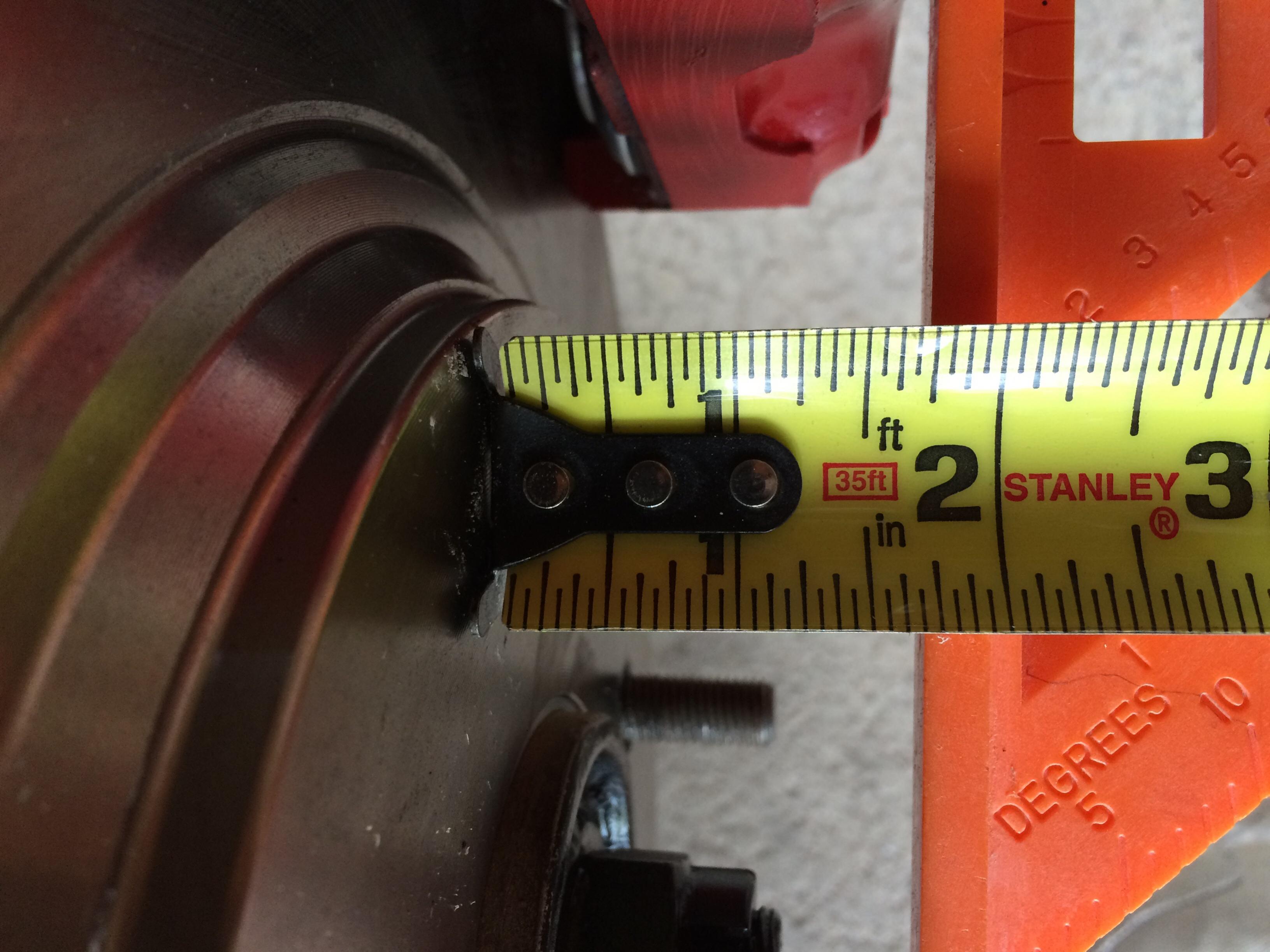

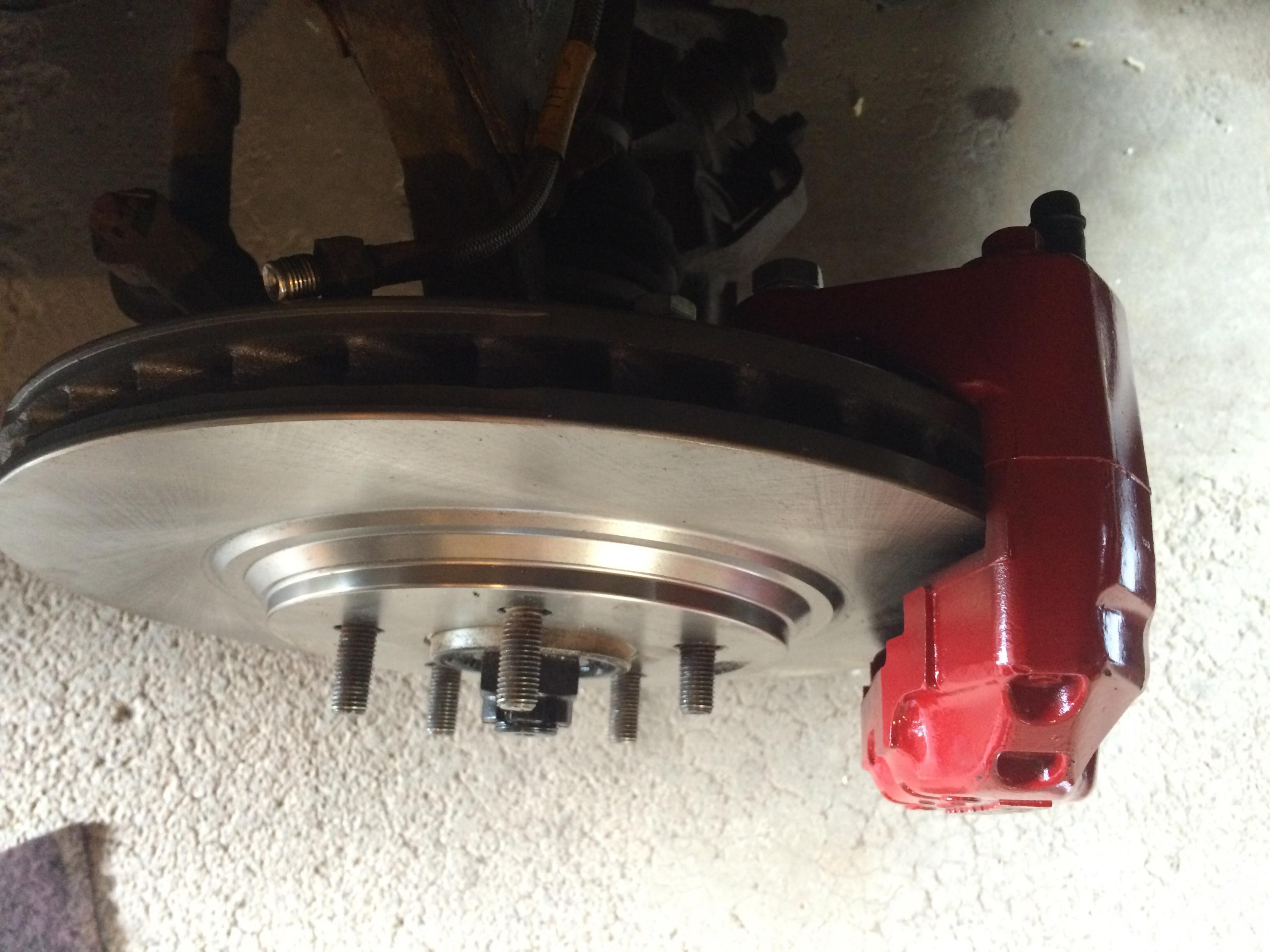

Time to bring this one back. So I finally got all my brackets, rotors, hub centric rings and rebuilt my 3kGT VR4 calipers and they don't fit my +42mm RPF1's, F^%#. I love the 13" rotors, so I guess the Cobra calipers are in. Any word on these brackets?

They stand proud of the rotor surface by 1.75", I didn't realize how huge they were.

Damn iPhone pics.
