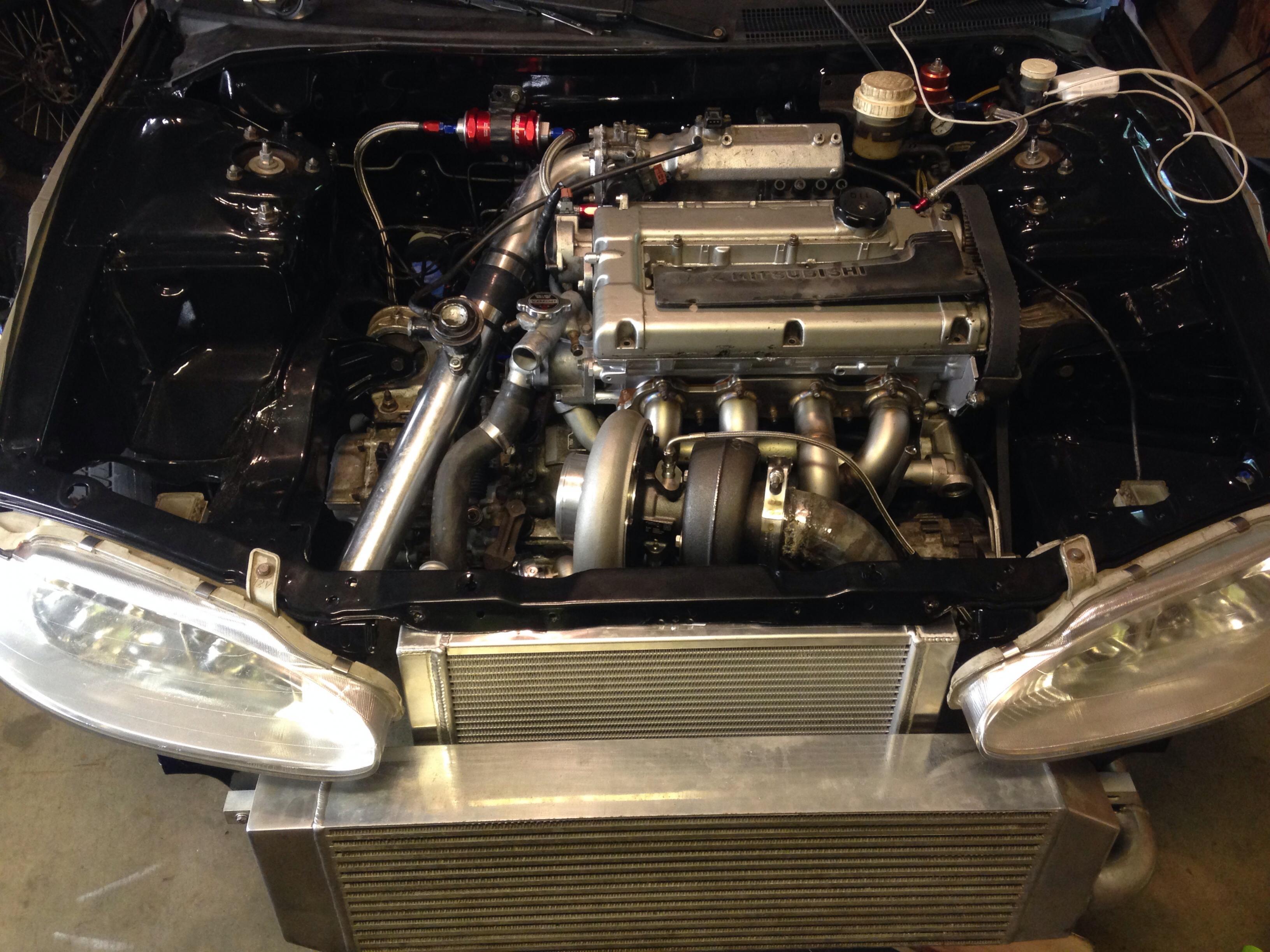

Soo how's this look? 😝😄

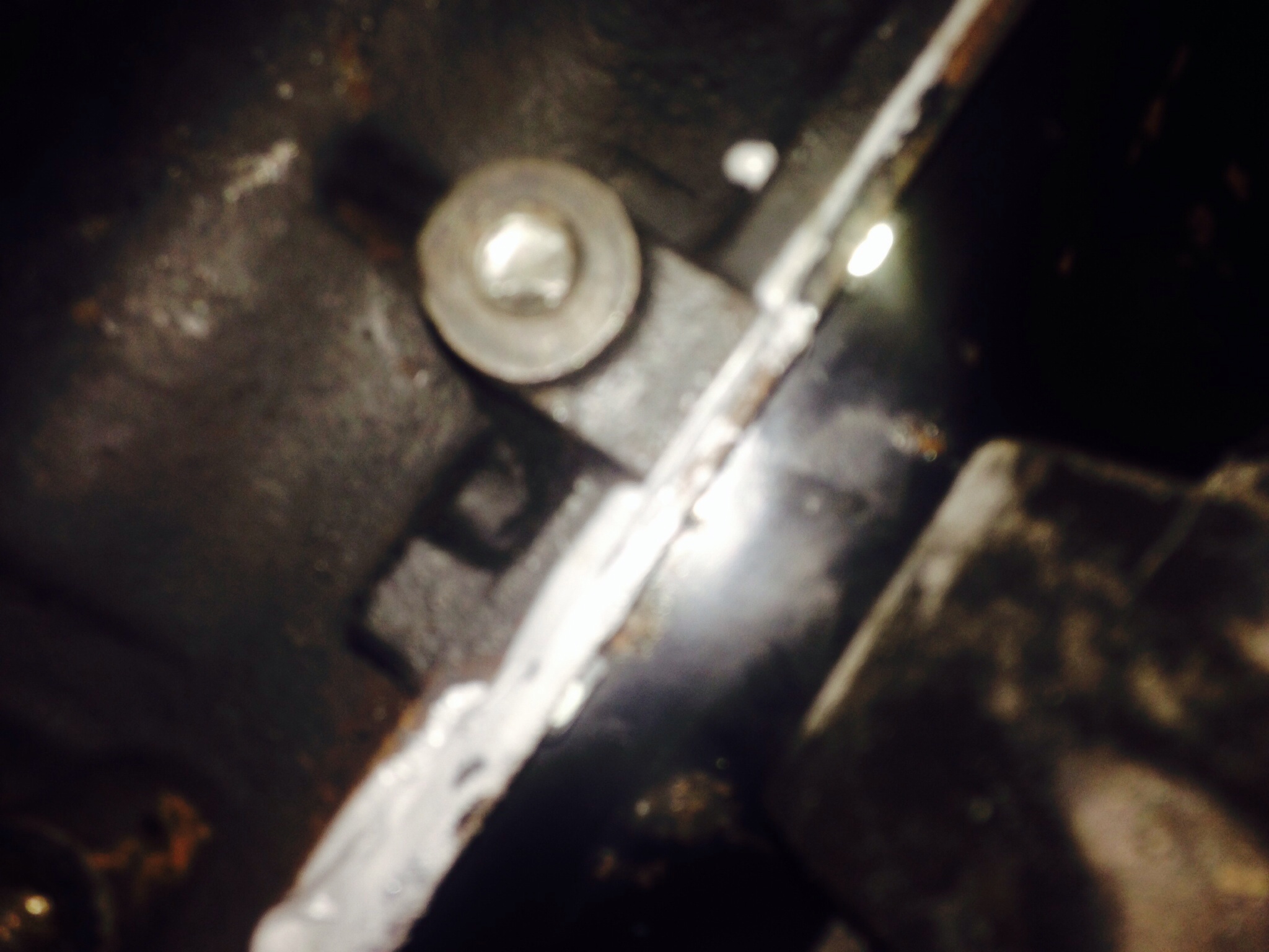

Well the engine might have to come out.. Didn't see the previous owner snapped a bolt in the carrier bearing on the block. Not happy. 😡 going to see if I can drill it out but it's a tight angle.

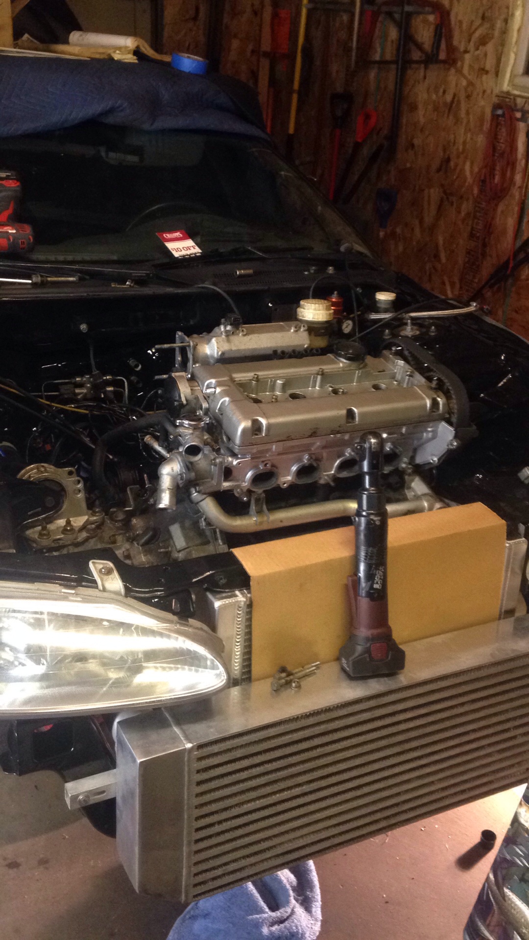

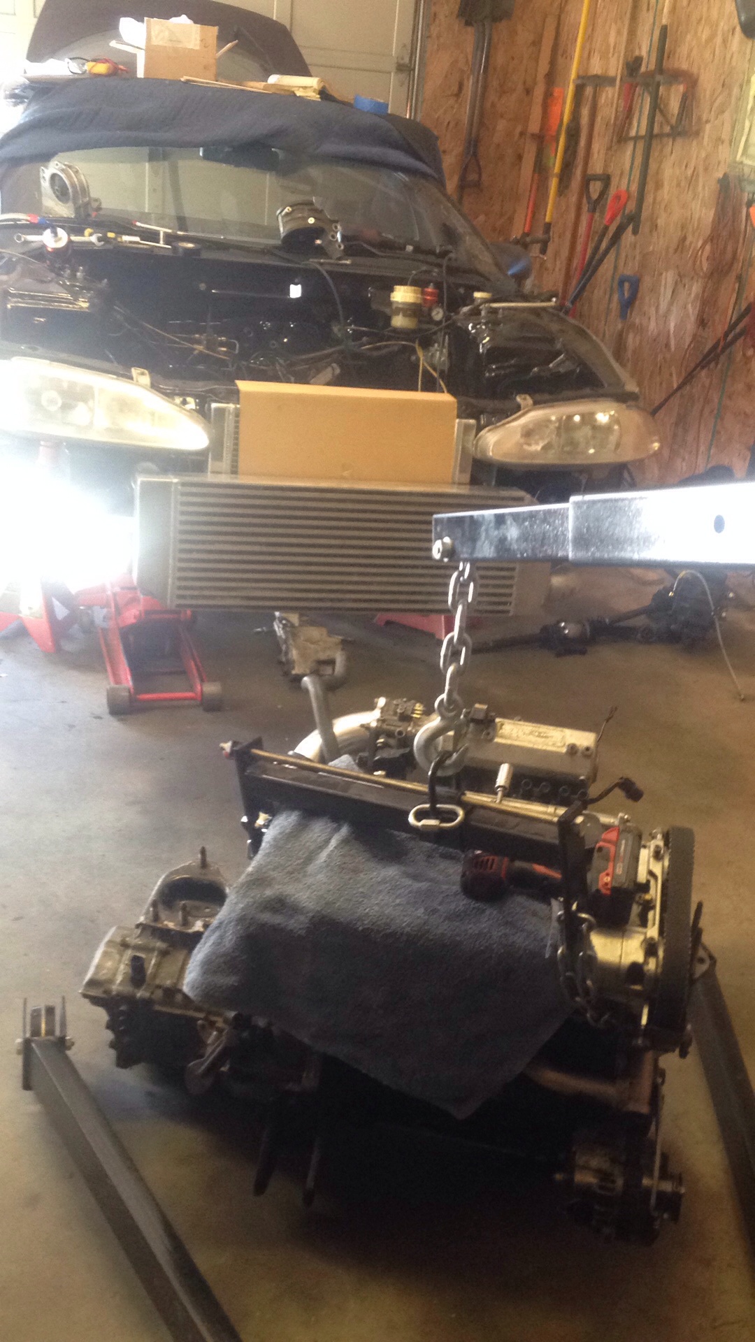

Back out, gotta drill it

Bolt came out, drilled and used an e-z out.
Got the engine back in. Just waiting on my manifold, then make an exhaust still.

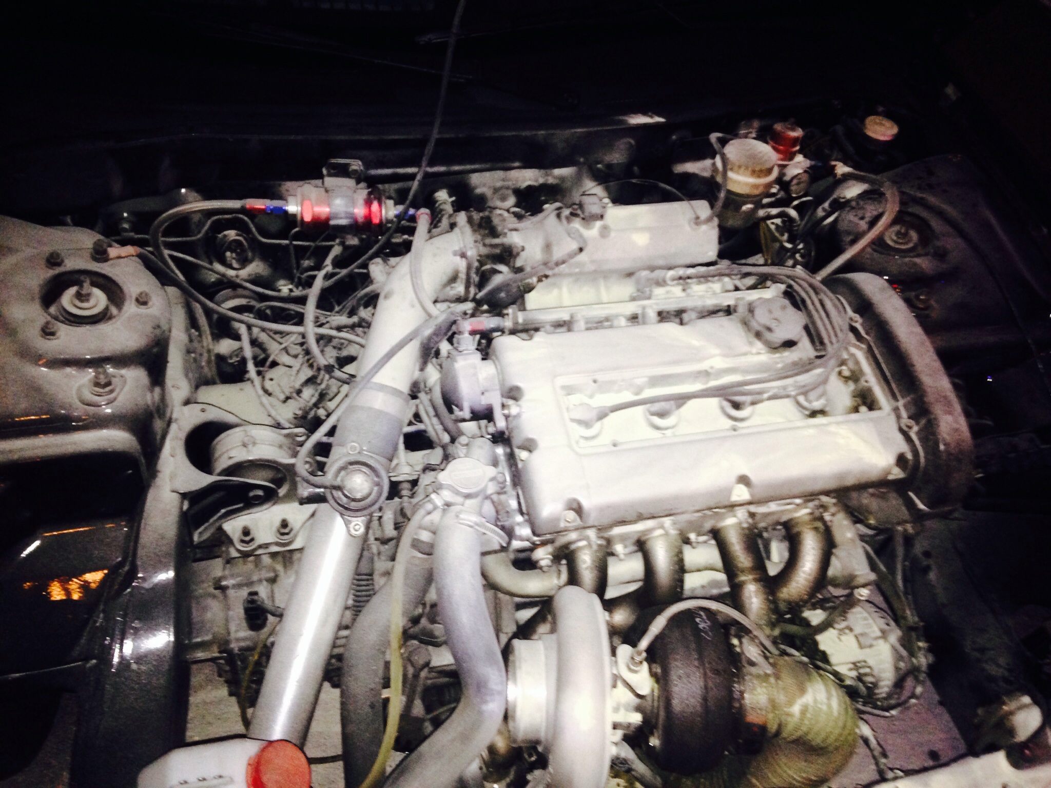

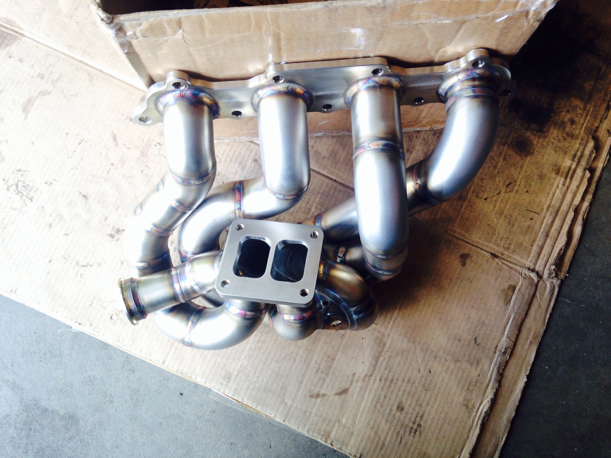

Old 06-07-2016   #65
mark4g63t
mark4g63t's Avatar
Join Date: Jun 2012
Location: Twin Cities
Drives: 95 Talon TSI
Posts: 941
Re: Mark's Talon
Manifold came! Got a couple days to throw it together and get some break-in miles on it

Old 06-12-2016   #66
mark4g63t
mark4g63t's Avatar
Join Date: Jun 2012
Posts: 941
Re: Mark's Talon
Hoping to start it today!
BW8776, e-85
Old 06-13-2016   #67
mark4g63t
mark4g63t's Avatar
Join Date: Jun 2012
Posts: 941
Re: Mark's Talon
Got it started! Soo loud with only the downpipe on. Running a little rich (it's now on speed density) soo I'll have to lean it out a little. Only one oil leak from the feed line.
Gotta get some insurance on it again and go break it in!

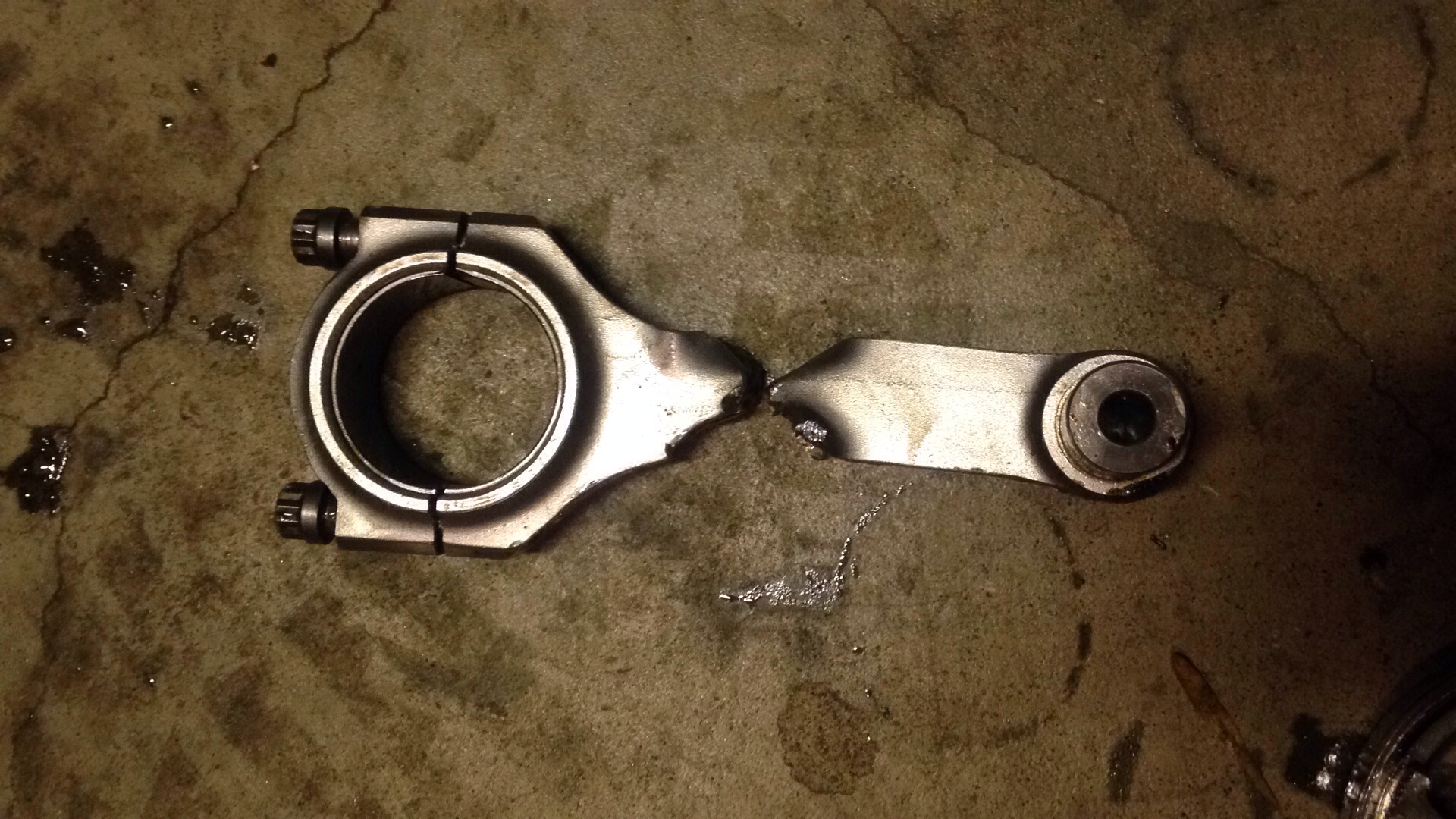

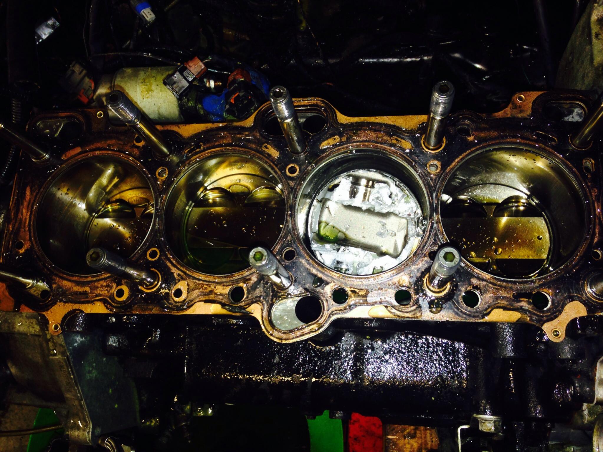

Re: Mark's Talon

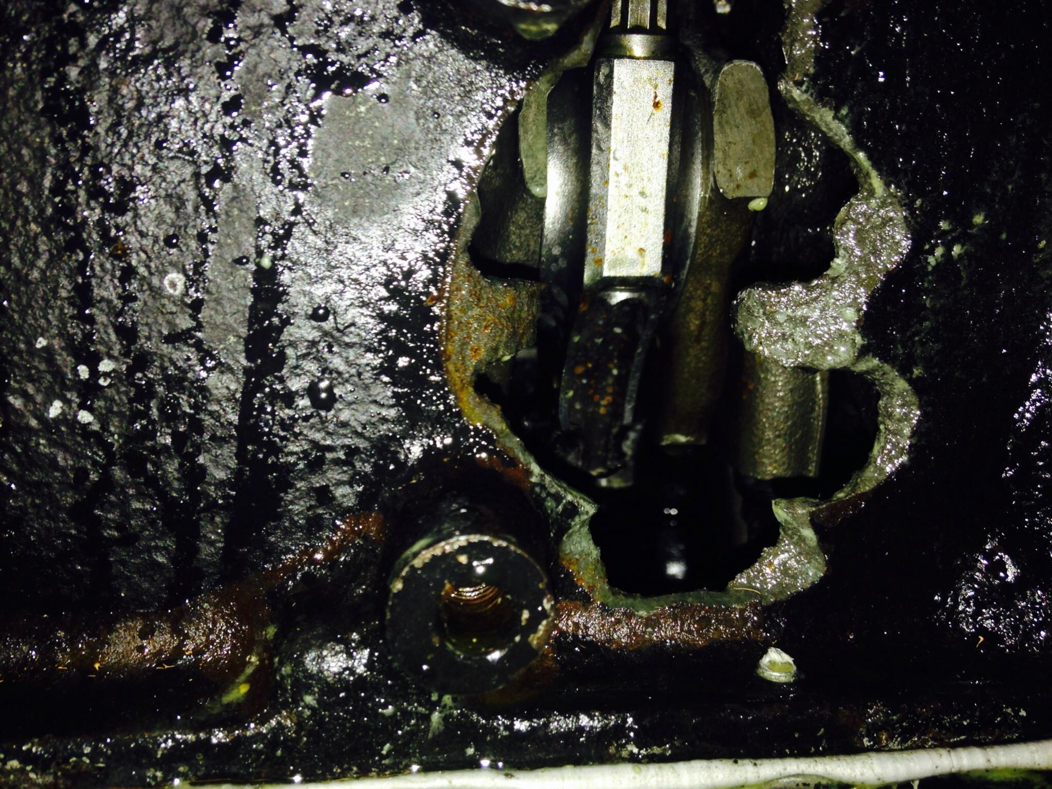

Had a little mishap happen.. Got on it and from the log the battery voltage dropped and caused it to go lean (11v on 30psi went to 13.5+afr).. #2 rod ended up snapping in half and breaking at the wrist pin, putting 2 holes into the block. Oil that shot out caught on fire and melted some of the wiring harness.. Thankfully had my fire extinguisher!

More carnage pics.. Harness is slowly getting put back to working condition.

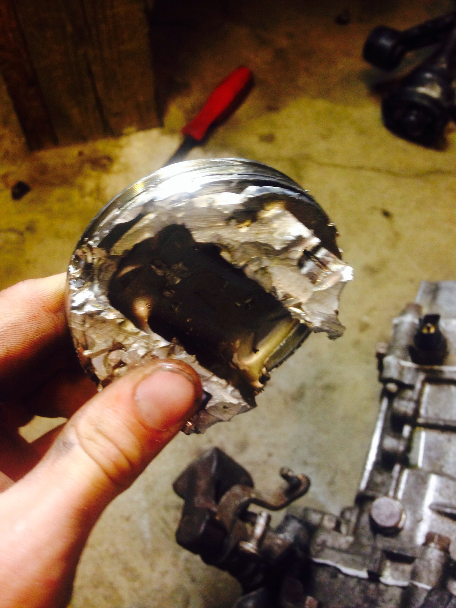

What's left of #2 piston

Re: Mark's Talon
#2 rod
