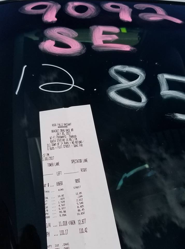

Finally got the car to the drag strip at the end of July.
XS Power longtubes - Catted
Corsa Catback
Air Bridge from Southern Car Parts
Blackwing Intake
MSD Wires
Tuned by me (Complete Tuning Solutions)
83,500 miles, untouched drivetrain and engine from throttle body to exhaust ports.
Bunch of autocross bits and other non go fast straight line mods: including alignment, DRM Shocks, DRM steering rack bushing, DRM caliper pistons, SS brake lines, C6 Z51 swaybars, six shooter shifter, etc.
Which category?
- External Engine Modifications (Bolt-Ons)
Example for 1/4 mile:
60'............. 2.012
330'........... 5.546
660'........... 8.405
660’ mph... 86.45
1000'.......... 10.832
1320'.......... 12.877
1320’ mph… 110.42
Comments:
OEM clutch wouldn't take more than a 2500 rpm slip without turning the car into a CVT with massive clutch slip. Best 60' was a 2.001 with a slightly more agressive slip, ran a 12.95 and a 12.96 to back it up. Rockfalls Raceway 7/31/17, 838 foot elevation.
Density Altitude: 2721 feet
Relative Density: 92.28 %
(per drag times calculator)
Next up is a clutch upgrade!

Very nice. I plan on going this weekend with my vette. I hope i can pull off a 12 sec pass. Might be hard as I don't have headers or much seat time launching the car. Congrats on the time slip. Think you could of gotten 12.5x with a better clutch?

Yeah the car should have a 12.5x in it with cooler temps and a better clutch. I'll find out later this year hopefully.
