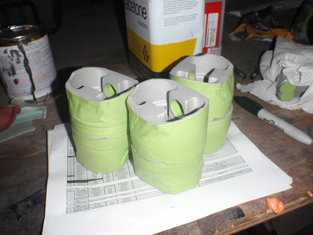

I got in my custom CP pistons from www.maperformance.com which went really smoothly. They were custom spec 9.5:1 compression ratio CP pistons. maperformance was great to deal with for doing special orders and even got on the ball immediately when CP sent standard bore pistons instead of the ordered .020. the Correct ones were in within a week which was awesome considering normal time for custom spec pistons seems to be 4-6 weeks. I also decided not to go with the Crower rods I have and to instead go with Manley Turbo-Tough rods which will handle my goal of building the motor to take 1300hp.

They will be up tomorrow or so. Stay tuned!! I had map do the entire coating process to the pistons so things are backed up a little bit right now since I decided at the last minute to have it done.

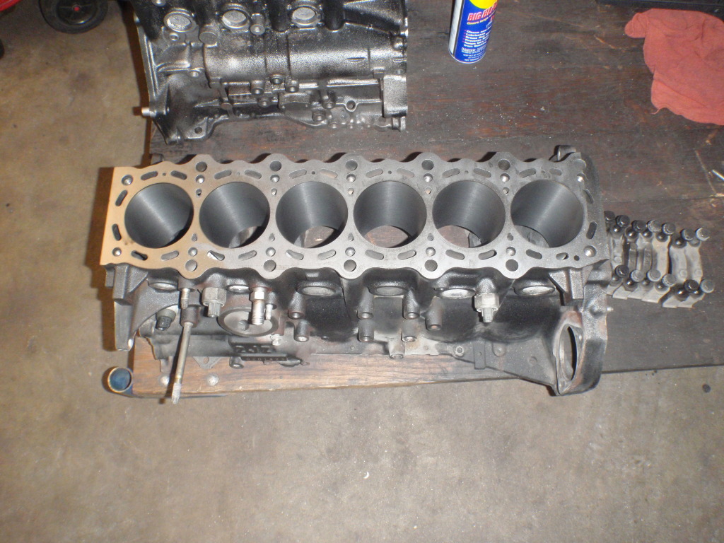

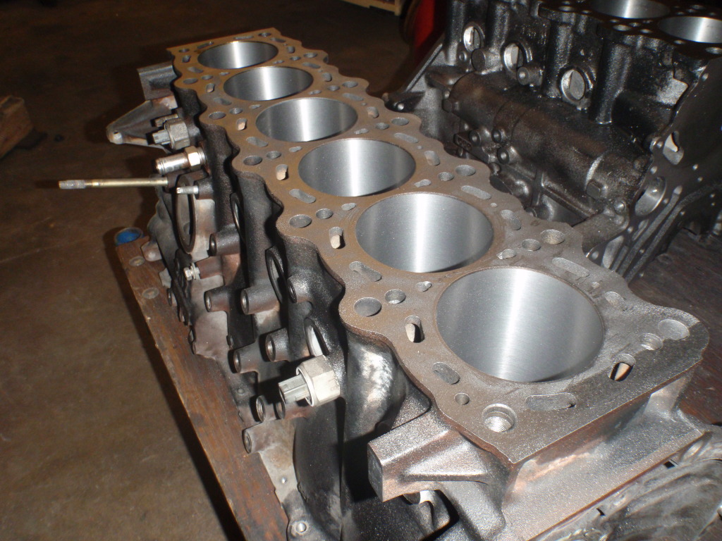

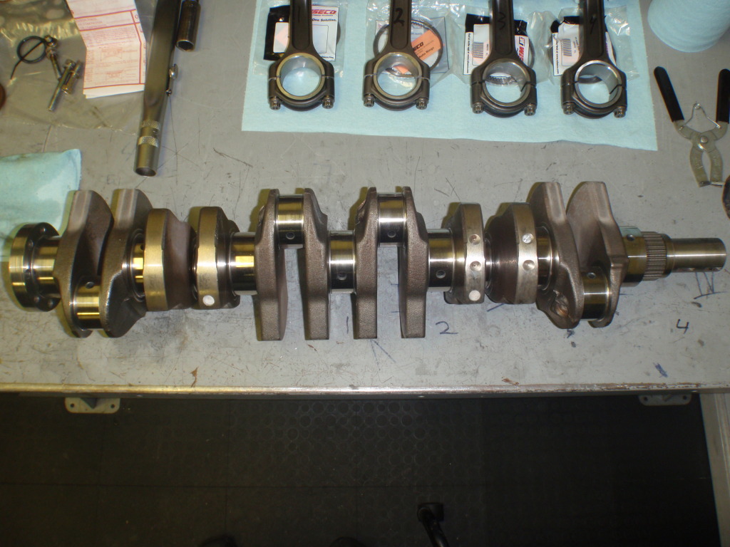

Thought I would snap some pictures this morning. What do I see a 2jz.
Block bored and surfaced ready to be honed. Pistons ready for coating. Freshly polish/balanced crank.
