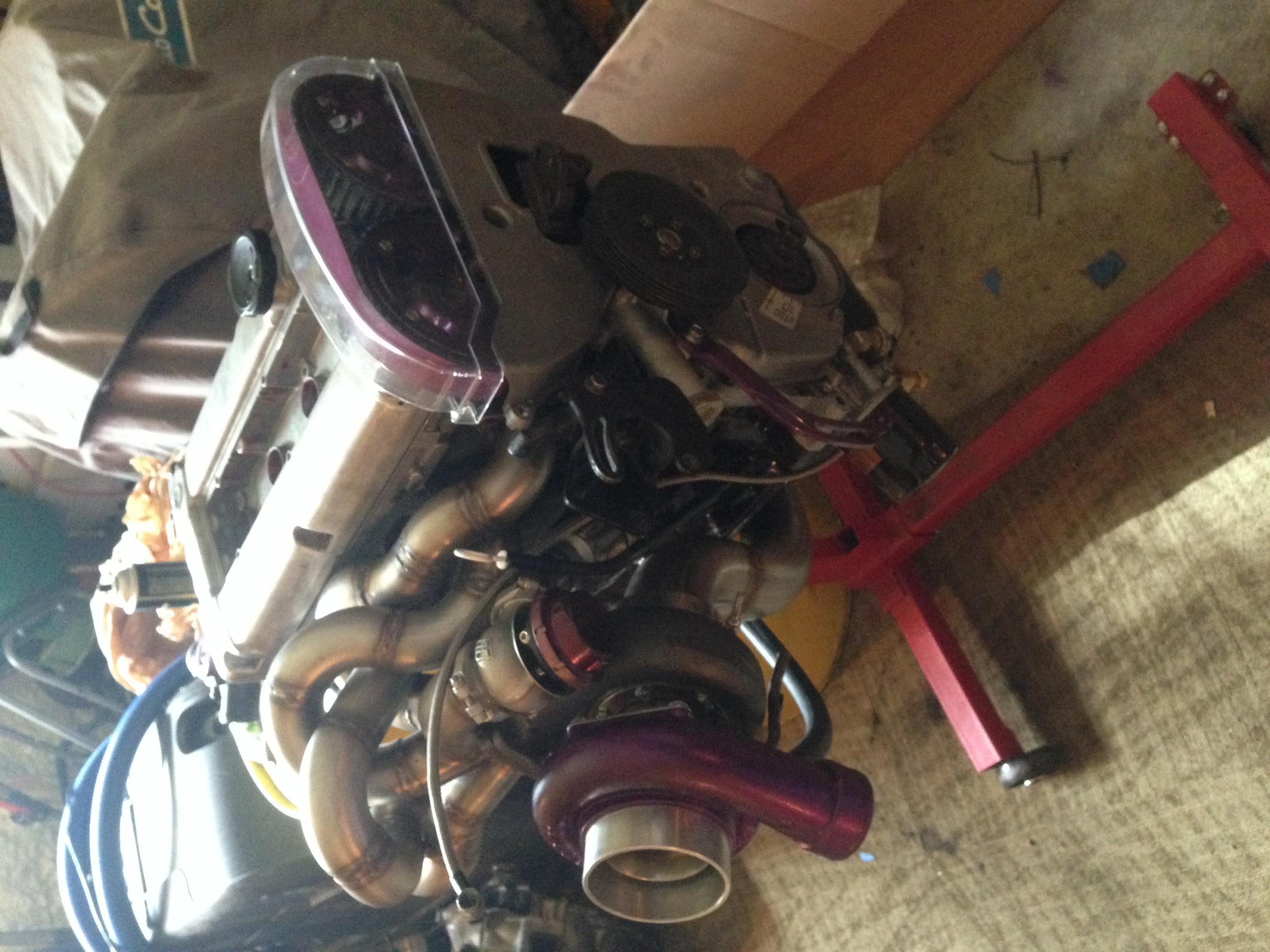

some updates, I have a new trans in route from canada. also I tore apart andre trans and lucky we did as we found a shim inside the center diff just waiting to be eaten up in there. Also his motor is now fully assembled and timed ready to drop in. sorry about the crappy lighting.

evotuner
evotuner's Avatar
Location: Mankato
Drives: 2004 Evo 8
Posts: 1,152
Re: team ab drag race and street builds
Yeah get some lighting haha, really cool builds you guys have going here. I'll be excited to see them at PG this year.

I tried fiberglass for the first time to make a duct for the turbo. I never really knew how easy it was to work with, I am pretty happy with how it turned out. Basically made it run over the flange on the compressor housing so I couldn't just accidentally drop something in turbo when working on it. Got my tranny and motor installed and starting to weld some v-band stuff up and intercooler piping. The front facing manifold is kinda making everything a total nightmare. The hood I got from cornfed hits on the manifold and not sure what I am gonna do to get around that. I am pretty sure any stock style hood will not work. The Seibon is essentially only 1 layer thick were it hits. Also intercooler piping is a pretty big challenge between the radiator support-intercooler it is a pretty tight space. I am open to suggestions on hood if anyone had any thoughts or maybe a better style of hood.
What do u guys think?
