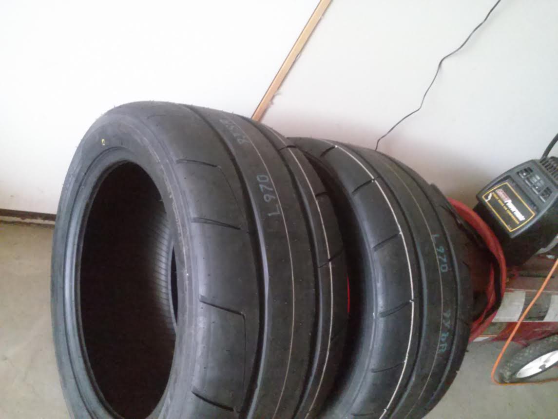

Need to get these babies mounted asap!

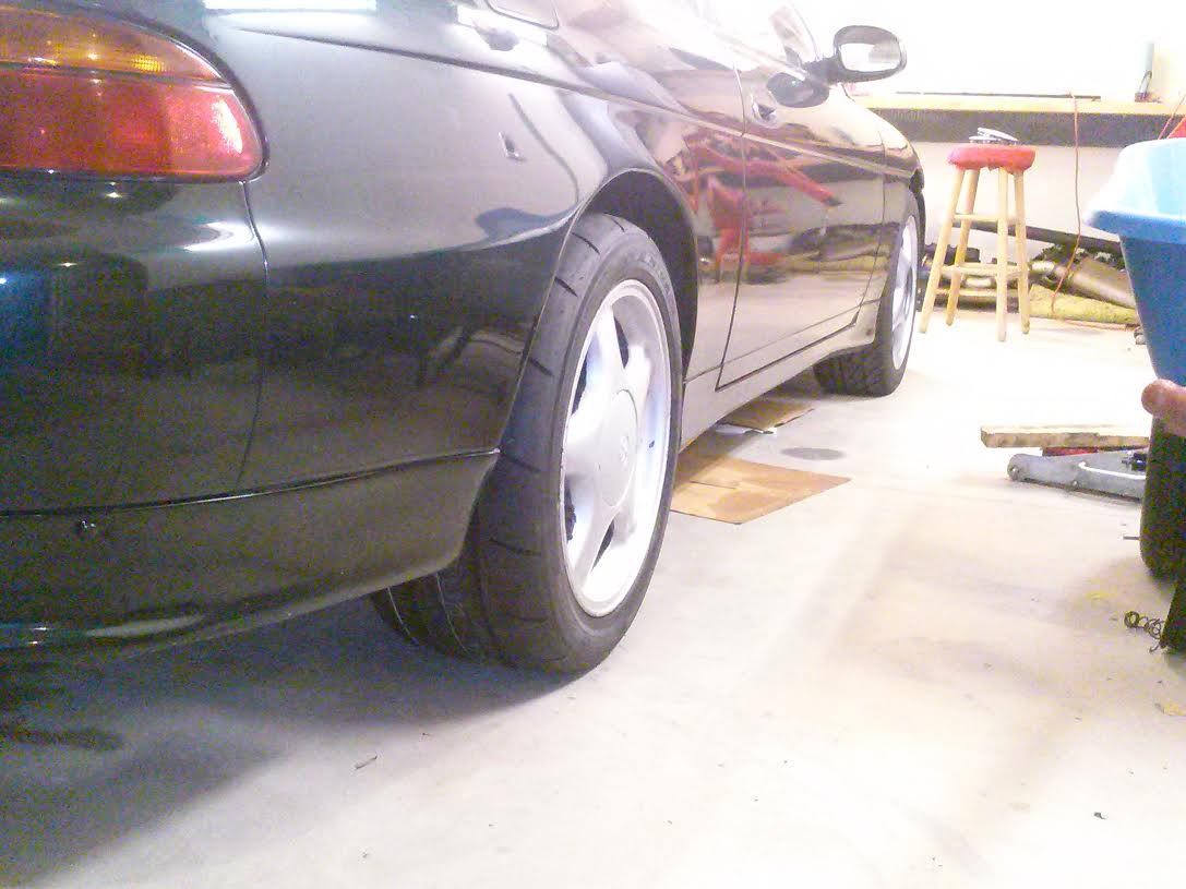

And on. Mounting the tires fucked up the plastidip on the wheel, so I just peeled it all off. Peeled off pretty easy. I hated the way it turned out anyway so no big deal. But kinda sucks if I want to dip them again a different color, seems like every time I swap on tires I'd have to re-dip them.
