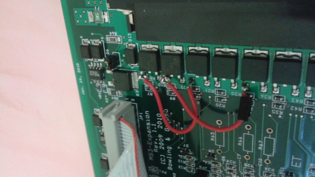

Haha. Just heard back from DIY, they gave me the text book answer of "replace the whole MS3x card, order it on our site. Thanks".
MS is cool and all, but just seems like vendor/product support leaves a lot to be desired. Then again I've never had AEM, Pro-EFI, etc so I don't have anything to compare it to. Maybe they're all like this. I still like MS, just anyone else considering it I think should be aware that it is very much DIY oriented, and expect to figure shit out yourself with minimal support. If it wasn't for Jordan in Florida that has done this a million times and helps me out, I'd be up shit creek.
Old 08-05-2015   #1165
Re: Project Lex
How much does that card run?
Old 08-05-2015   #1166
Re: Project Lex
$100 + shipping. I think all I need are two small chips however, probably a buck a piece. Wonder if I can just source some myself.
The two tiny black components (Q1 & Q2) soldered to the board are what I believe I need.

Considering it is DIY, and those look easy to remove, Id just replace them.

Yep, since MS3 is built to handle 8 cylinders, I'm going to replace the bad ones with the 'spare' ones to get it back on the road asap. Then probably figure out the manufacturer part number and see if I can't just order up some more and install them in the 2 spare slots later.

Fingers crossed that this works.

It's alive!

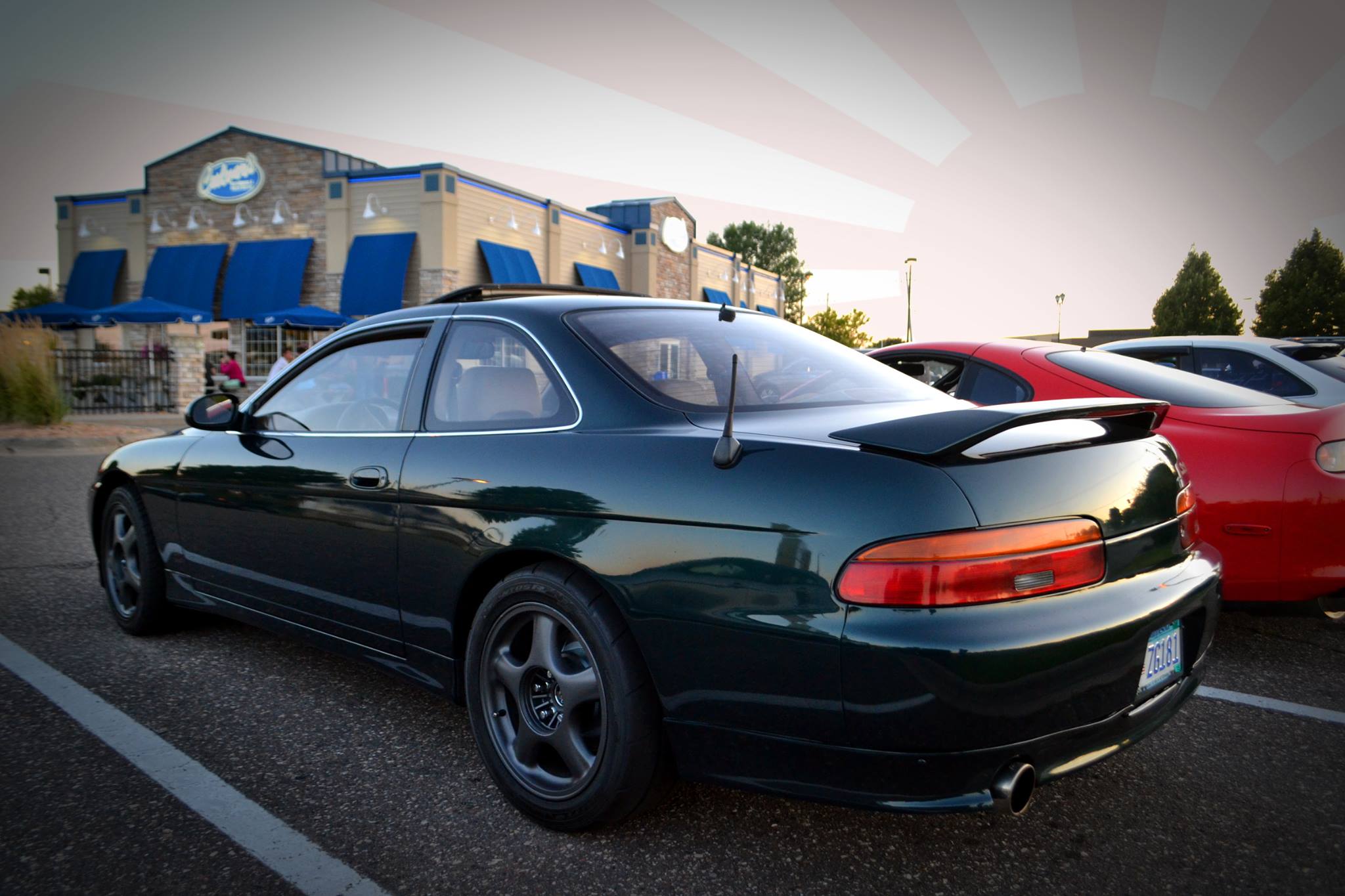

Some pics a fellow SC'er took of my car at this weeks UMMO meet. Thanks again Curt for putting this on, and letting us non-Mitsu's still come and partake! Thought they were probably the best pics anyone has taken of my car. Wish I had camera skills.
FYI wheels are plastidipped Anthracite metallic currently. Not sure if I'm digging it, may re-dip them in their silver metallic instead.

Looks good.

I didn't think the wheels looked half bad. Was good chatting last night! I have to get out to more of these.

From the pics, the wheels looks good this way.

Cool, thanks for the feedback. Im putting the center caps back on too which I think will look better also.
Old 08-12-2015   #1178
Re: Project Lex
Looks good to me, I like the dark look. Hard to make the stockers pop really, they are a very subtle design and they arent very big. Needs more low and a size up
Old 08-13-2015   #1179
Re: Project Lex
I agree with you bman, they don't look right I think I liked the silver better.
I think maybe because it represents a cleaner OEM style look to the car and the car is damn clean and has a sporty OEM look to it with the mods you have done.
Old 08-13-2015   #1180
Re: Project Lex
I think I agree with you Aaron, but it'll have to wait until next year. Done dinking around with them, just going to continue to enjoy this thing until the snow flies!
