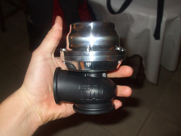

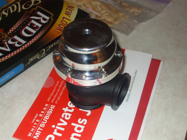

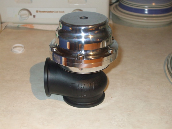

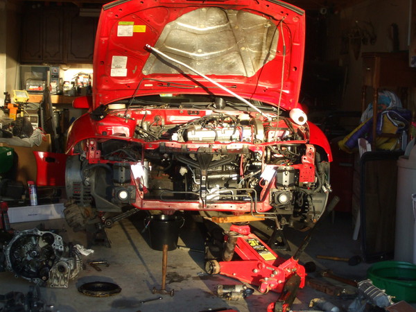

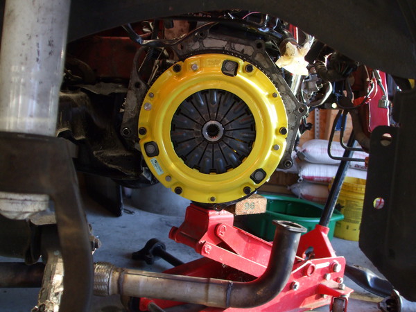

Some pics

Sorry I suck at pics... Idk why the last 4 aren't like the first 2.

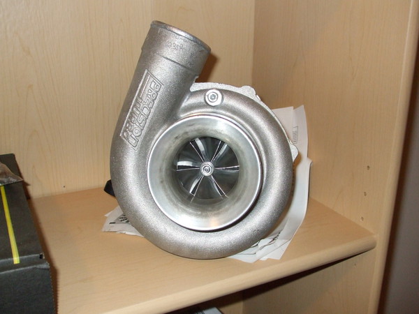

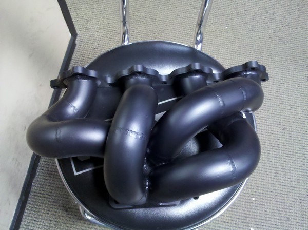

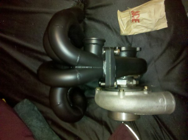

Manifold and turbo

Re: GsXtUrBo98's 2G project thread
Looks nice, why did u upgrade from the scm61? at 392whp you werent really close to maxing it.

I wanted a turbo that would take me to my goal power levels.. I know you like the quicker spooling turbos but I think that this being ball bearing and all with better flow from the other new supporting mods it will spool simular to the journal bearing and provide more power up top

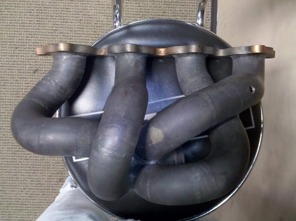

Suppose I could post this up on my own thread aswell. This was done by primo as a before when I got it from halon and then when I picked it up. Kinda funny its on the same chair at primo for both shots lol didn't try to do it.. But I think it turned out very well. I will be having the rest of my stuff ceramic coated through them aswell.

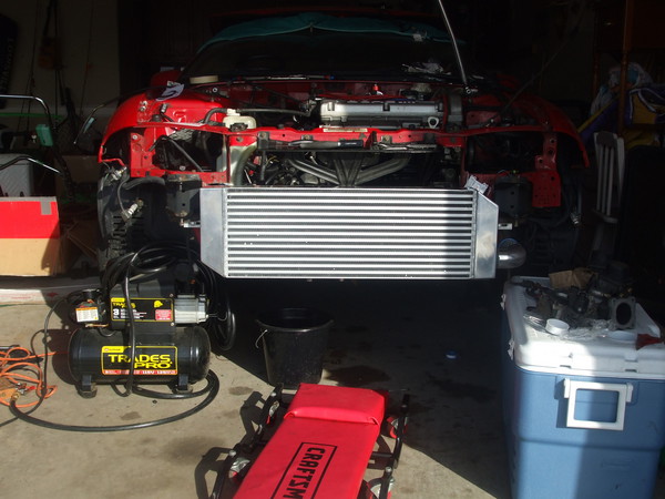

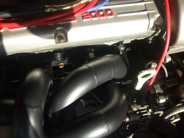

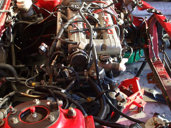

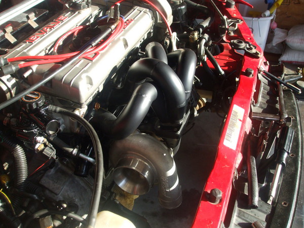

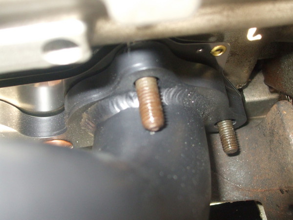

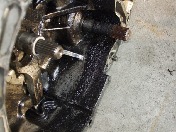

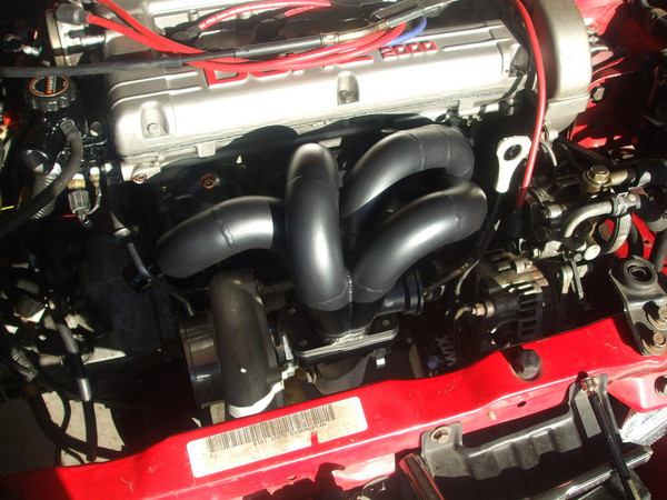

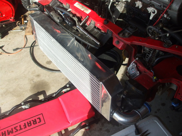

First, I mounted the front mount after cutting out the radiator support so it will fit with the worlds smallest compressor! took forever.
Next, I installed the manifold and turbo. Then ran into a problem with one of the studs being too long!! Map built the head and put in different length's and they said it didn't leak so just kept it the way it was. Which was fine until now..... Anyways here's some pictures of the progress.
That sucks about the manifold, at least once you get it all figured out it won't be too bad.
Is that the only one that hits? If so I'd just take the manifold off, thread a nut on the stud all the way to the head, stuff rags into exhaust ports, cut a little bit off the stud, back nut off and repeat until you get the right length.

Good work! Should be an easy fix. Also are you still using the 90 from he stock intercooler kit, that bolts into the throttle body? It was kinda janky and caused me some boost leaks so I switched to a N/T throttle body. Did you weld the bov flange to the upper intercooler pipe? or did they not cross thread on ya?
I have a N/A throttle body but was planing on using the stock one for the time being... if it causes me problems then away it goes. I just rebuilt the 2g tb so I'm kinda sunk on it but in the end maybe I will just throw on the N/A.... Also, I am running a tial bov so I had the flange welded on from them.
