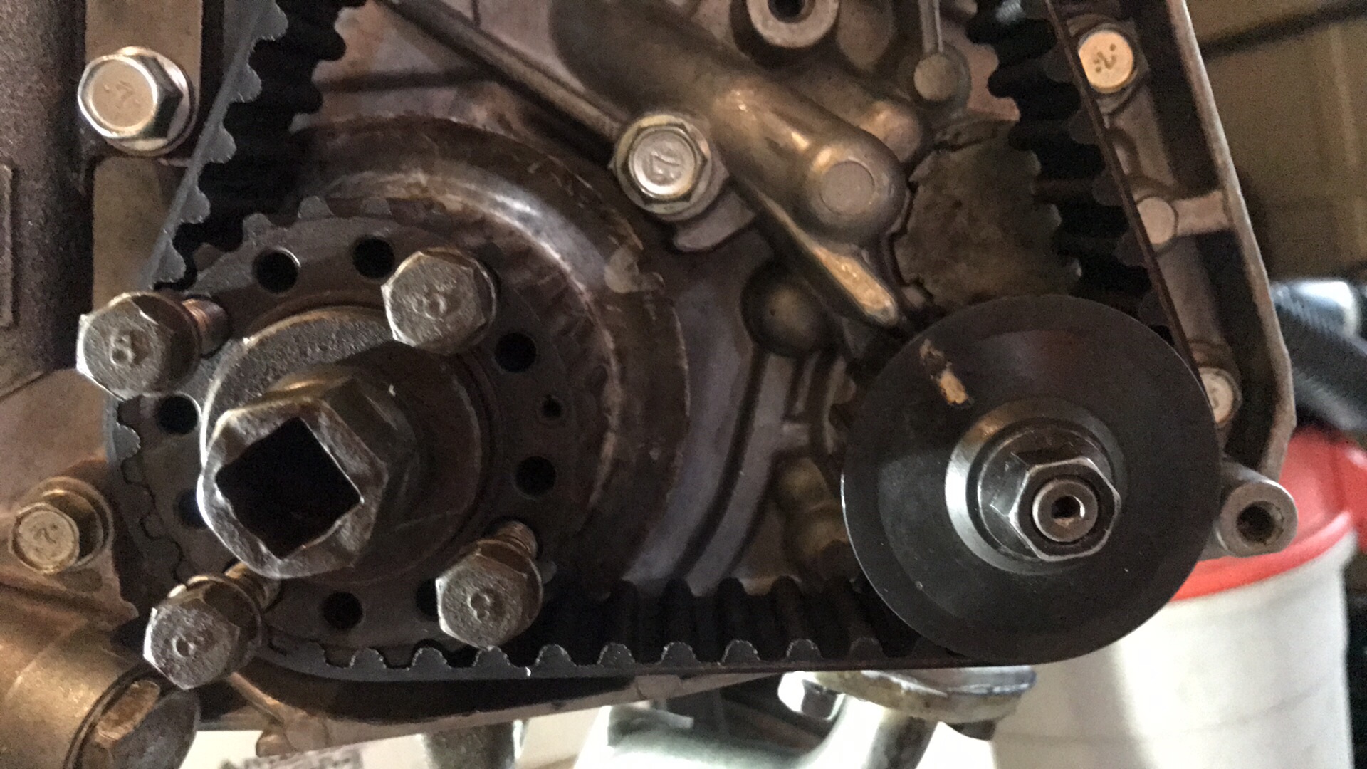

How's this look for timing?

Old 08-26-2017   #104
Re: Mark's Talon
Looks ok from the pic, but it's difficult to tell from pics. Only good way is to take a straight edge from center of cam gear bolts and verify the marks line up on both gears.

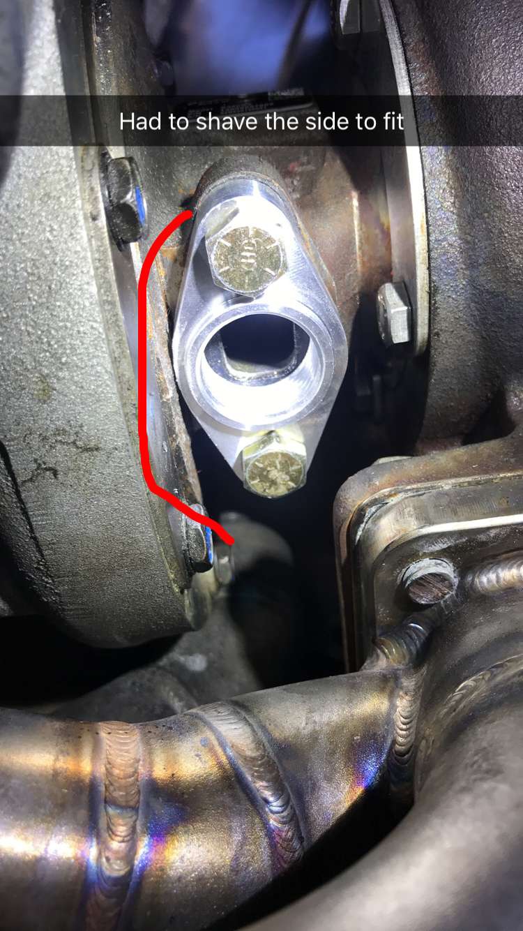

Drove the car around and turbo started to leak oil from the chra to hotside.
Got some -12 fittings and a new oil pan. Going to upgrade the return from the -10 to -12.

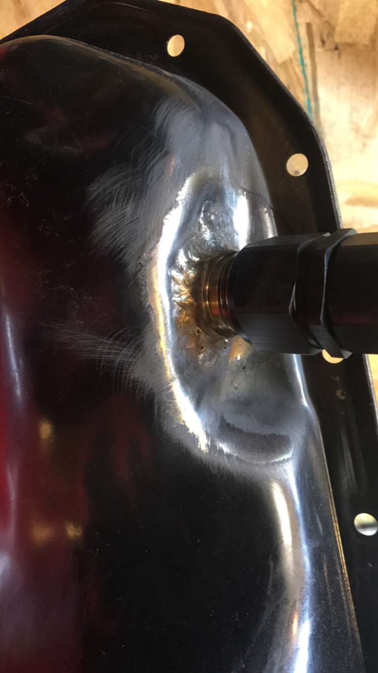

About to weld the oil pan bung on and make the hose. Hoping this helps.
The -10 to -12 is a big difference.

I would think -10 should be enough, the diameter of the oil exit on the turbo is quite a bit smaller than your -12 line. It's difficult to tell what horizontal/level is in that third pic, hopefully the drain line isn't going uphill at any point. Good luck with the tune!

It's a slight "uphill" at the fitting of the oil pan but not bad at all. So far so good no leaks. The -10 is smaller than the stock return so a -12 was definitely needed. Excited to see how the tune goes.

Yeah, I was wondering about how the return line dips below the entrance to the pan, but it seems gradual enough that the weight of the oil will still push it through. Looks good!
