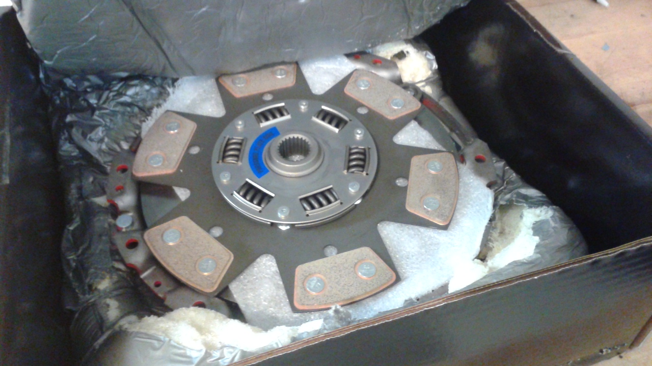

Progress is veery slow. But couple updates.
- Got my new clutch. It's a South Bend Stage 3, 2700lb pressure plate, sprung 6-puck disc. Rated at 715tq. SHould do nicely. If I run into issues, with it not holding, I can upgrade to their Extreme pressure plate in the future (3000-3200lb).

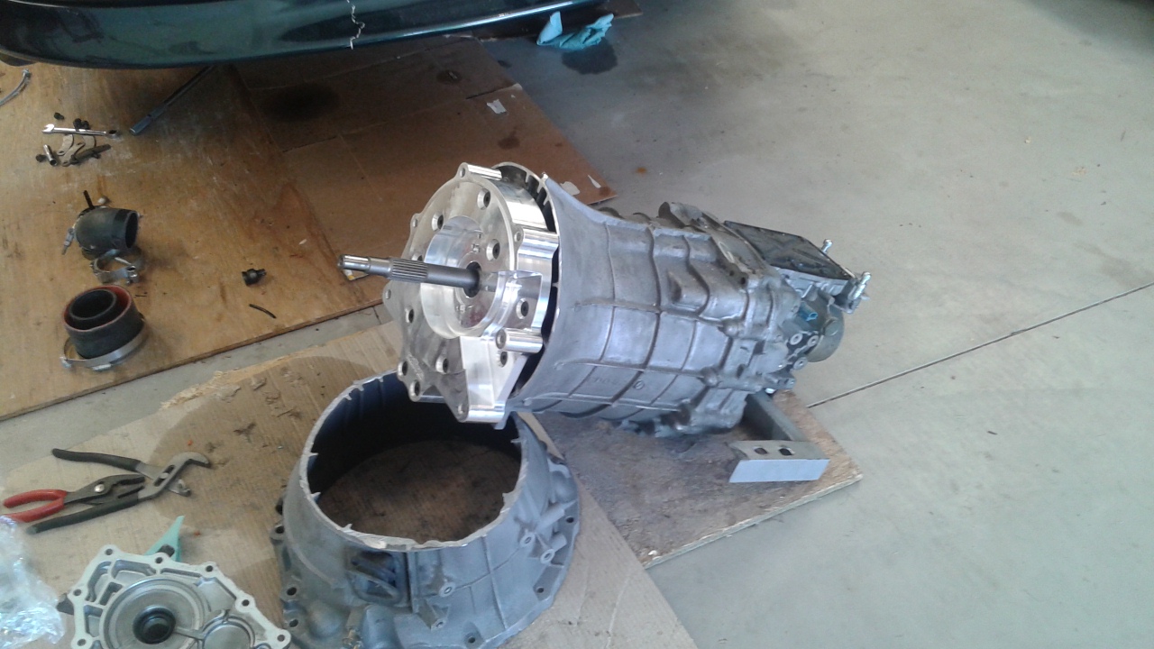

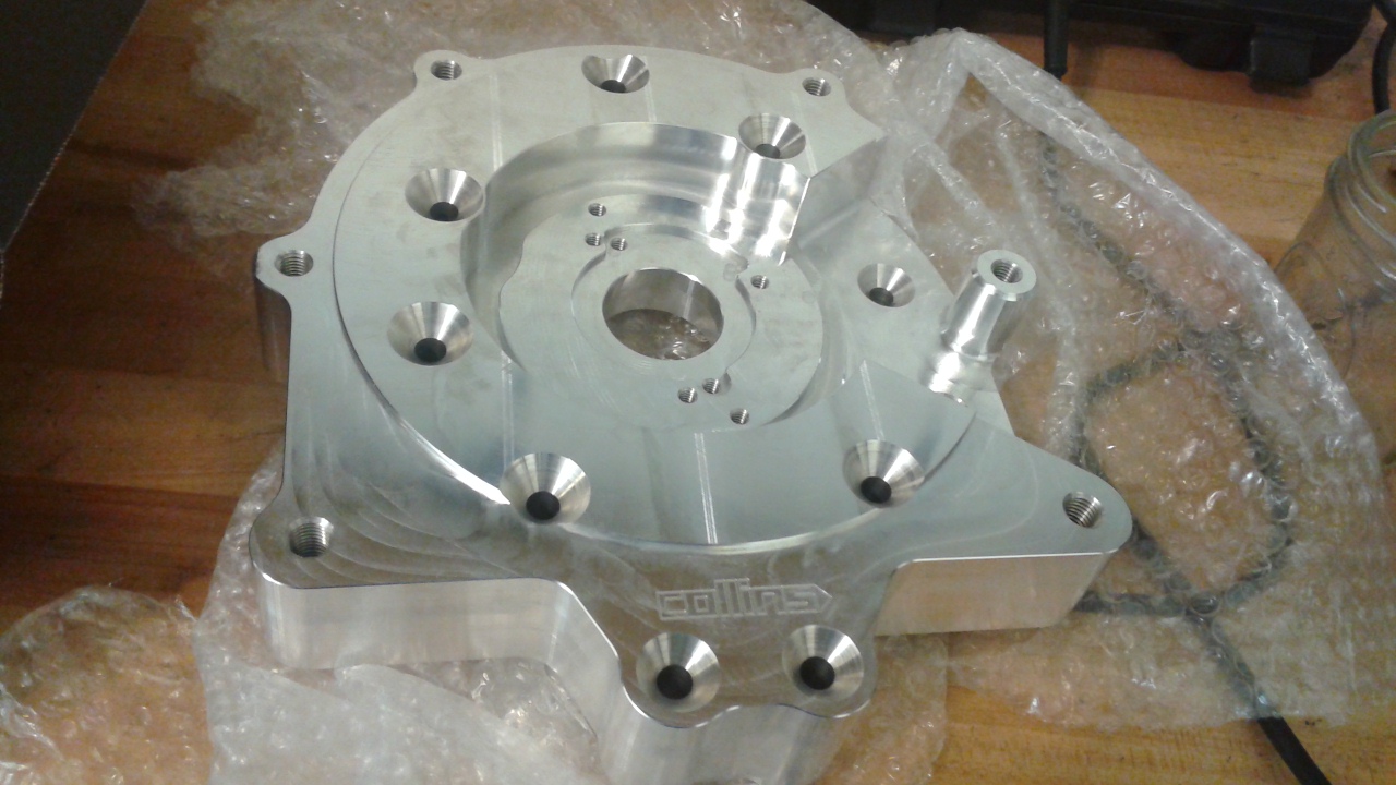

New adapter came in. Looks really nice. Time to get out the grinder and start chopping off the bell housing!

- Got the bellhousing cut off the trans. Got the input shaft cover off and the stud shaved down. Waiting on a seal, should be here in a couple days, and then I should be able to mount the adapter to the trans. Also still waiting on Flywheel...

Lookin good! Crazy that you had to cut the bellhousing off, I didn't realize you had to do that, thought the adapter was a bolt on type deal. Takes some testicular fortitude for sure!
Old 06-27-2016   #1333
Re: Project Lex
The 350z trans doesn't have a removable bell housing. So u chop it off. But then that exposes the input shaft cover which is held in place by 11 bolts. So th let adapter bolts to that.
If you go on Collins website, he has a vid of how to do it. His vid is a T56 adapter I think, but same concept.

Got the adapter plate mounted to the trans today.

So with the bell housing cut off, installing the tranny should be much easier right?! If so, that's a big bonus.
On second thought, there has to be some new bell housing right?
NSX - S480/Built motor
GSX - 571whp/490wtq
Sienna
Old 06-29-2016   #1336
Re: Project Lex
Yeah that's the idea, and the whole reason I'm doing it. The OEM 350z bellhousing is massive. This will use a SC300 / NA Supra auto bellhousing. A bellhousing designed to fit this car. So 'hopefully' it will make install / removal way easier. I guess I'll find out...

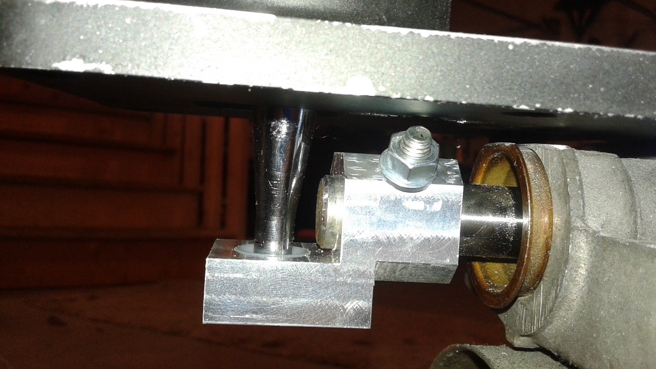

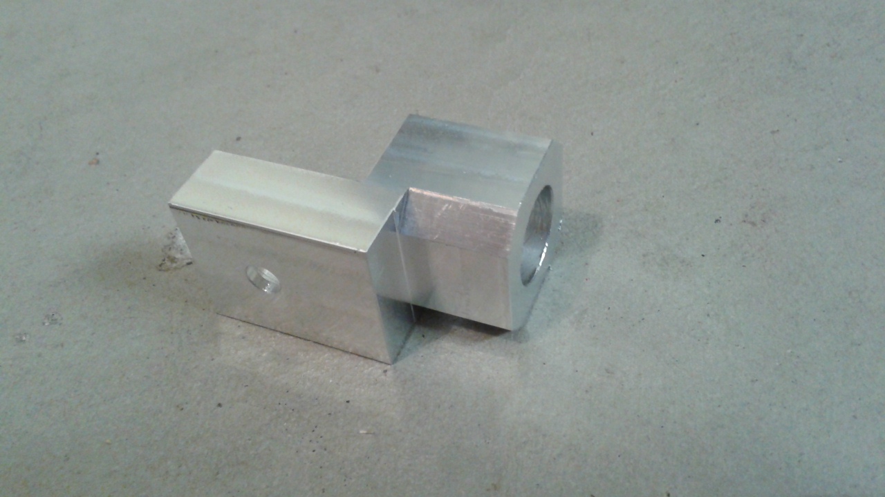

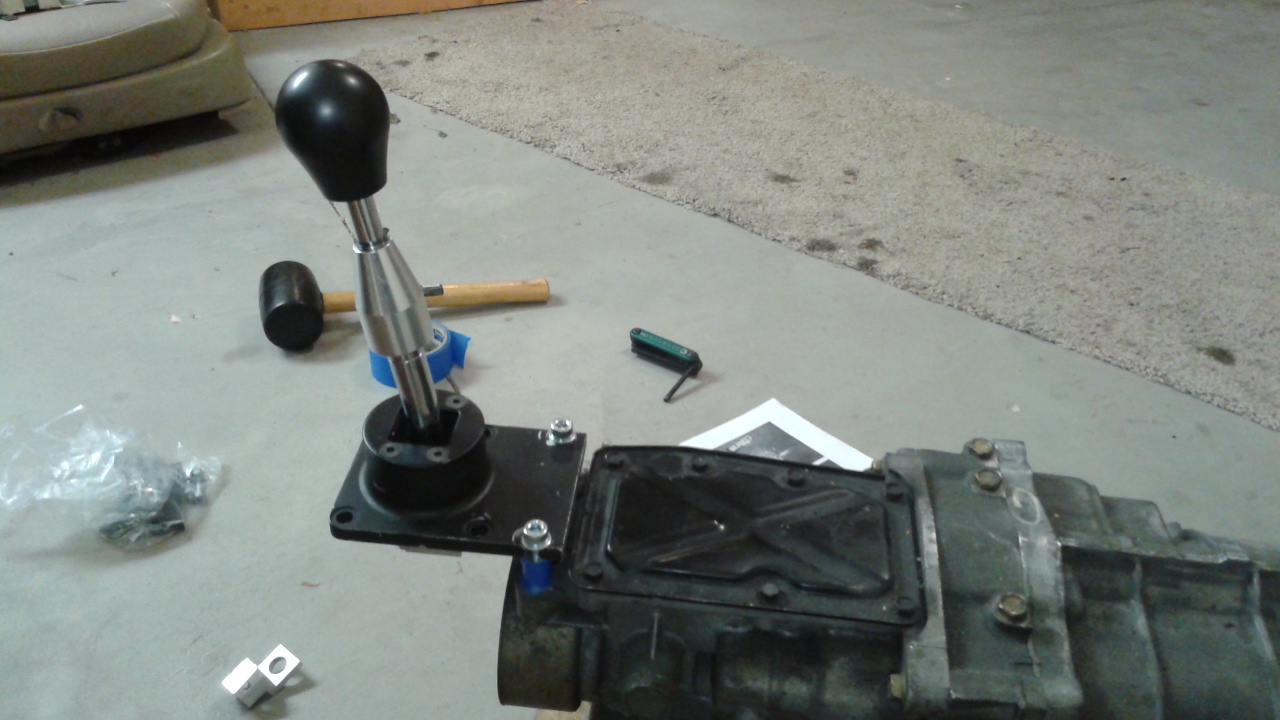

Some small updates here. I got the AEM mounting plate cleaned up at work a bit. As good as I care to get it. Pretty happy with how it turned out, considering it was just like a $8 chunk of plastic
Got the 3rd design of the shifter fitting back from getting machined today (Thanks Rosey!). I think this is pretty much done. The shifting left to right is so close, I feel like I'm going to be experiencing a lot of miss-shifts. But everyone keeps telling me you get used to it. So we will see.

Glad it fits! I like the updated rev with the thicker bottom and counter bored hole.
Old 07-01-2016   #1339
Re: Project Lex
nice work!
Old 07-01-2016   #1340
Re: Project Lex
Me too. I hope it didn't create that much more machining work for you. Hopefully next week I'll feel comfortable enough to say it's good to go and see if you can make a couple more to finish off that chunk of aluminum. Thanks again dude!
