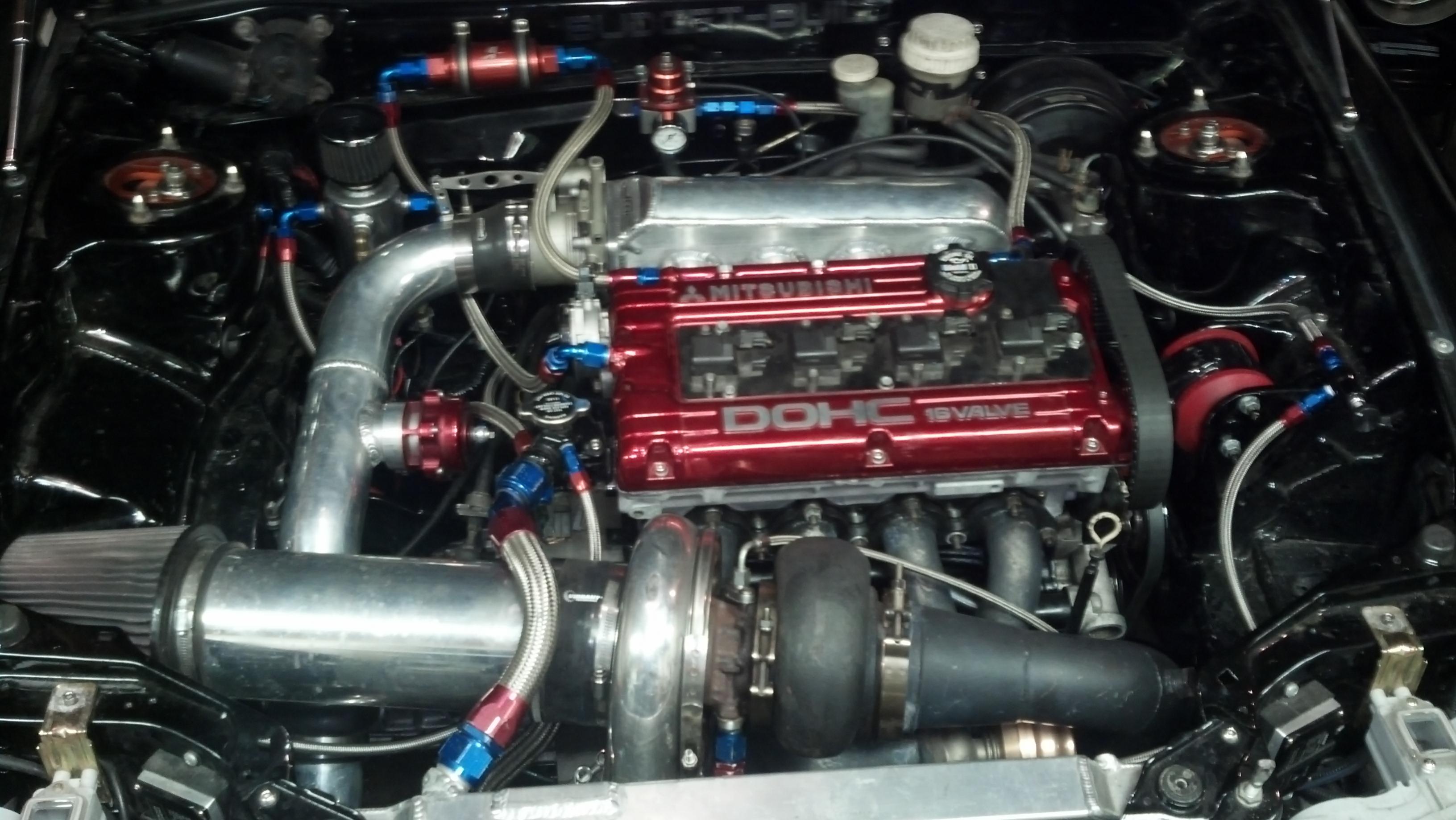

I was up late working on the car last night. She's just about ready to fire up. I just need a couple tbolt clamps for one of the ic couplers, replacement filter for my oil fees line, adapter fittings for my oil cooler, and to mount the cooler.

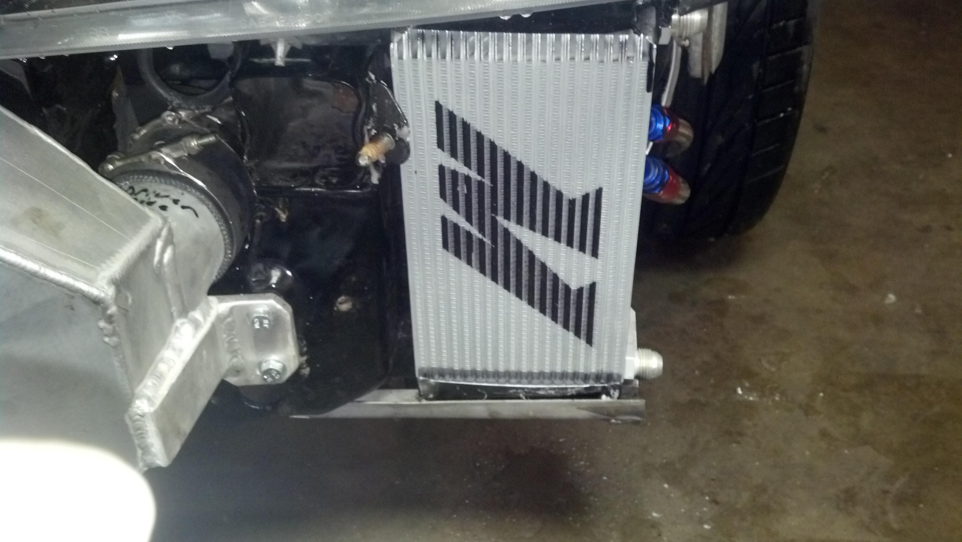

Last night we mounted up the oil cooler and filled the cooling system with coolant. I got the fittings to make my lines fit on the cooler but forgot them at work and wasn't going to go back and get them. So we're planning on finishing it up on Tuesday night and doing the initial start up and run it for 20min. Then it will sit until we get some spring weather.
I also picked up a boost-a-pump from cornfed2.4. Just have to make sure it's the right one before it's installed. I'm going to get a few interior parts from his 1g to help clean up the interior of my car.
