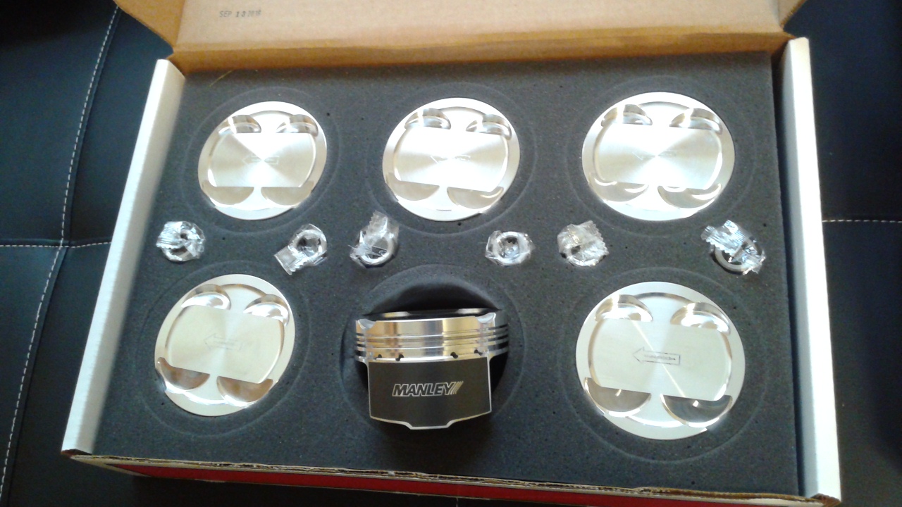

Some parts arrived in the mail today. Thanks Tony @ Real St.

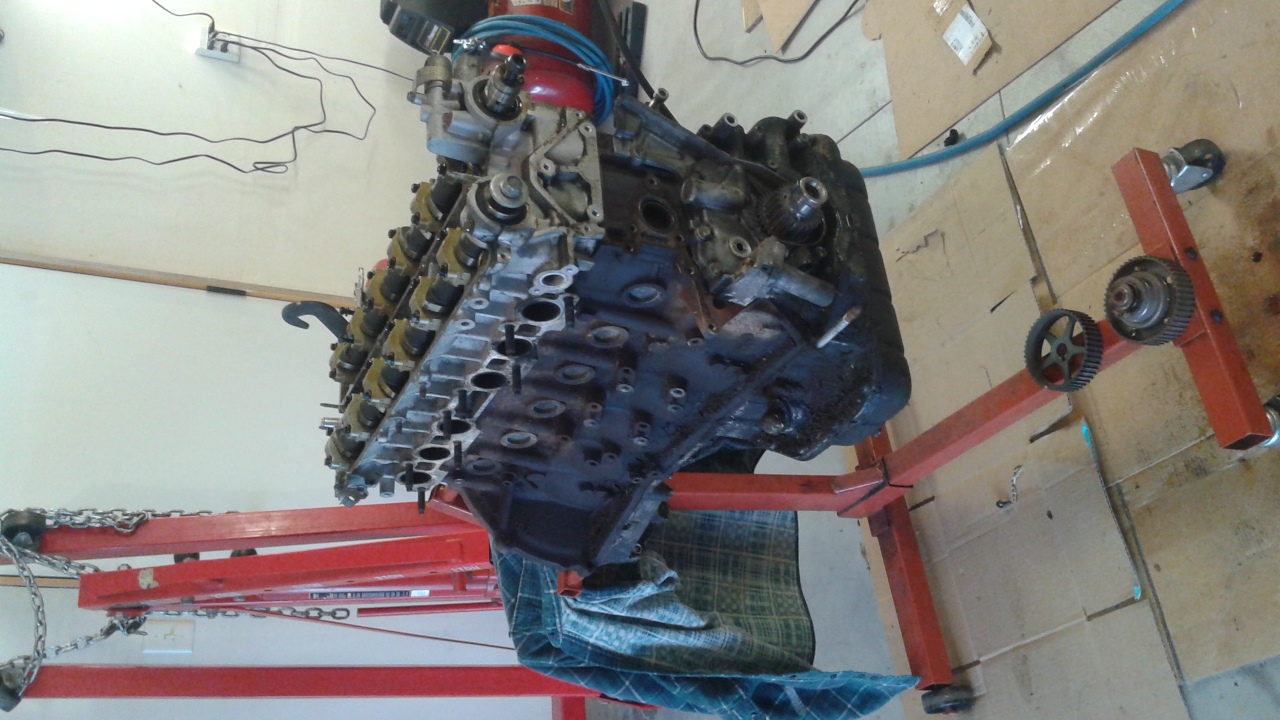

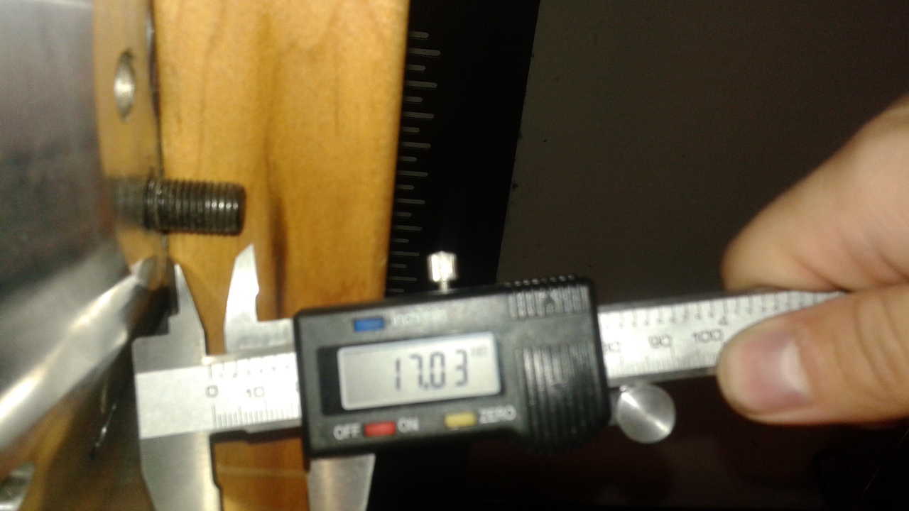

Next I got the motor stripped down mostly here. Dan said that's good enough, so I'll hopefully be bringing this to him within maybe a month or so to start work on the block.

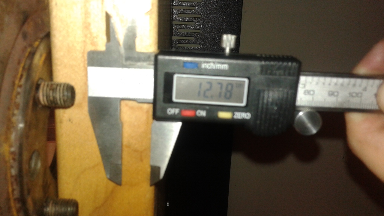

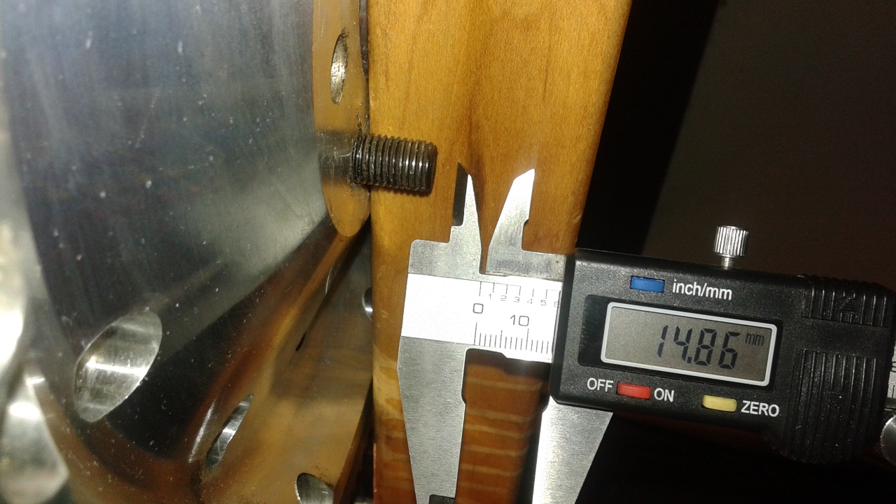

Next, I got the issue figured out with the engine not turning over. Long story short, the flywheel bolts were just a tish too long. So I torqued the flywheel down, but the bottoms of the bolts must also have bottomed out on the main cap on the other said of the crank flange, preventing the motor from turning. I was able to stack a few washers under the bolt head to get it to clear, but I will be ordering 35mm bolts so I have the correct size. The stock flexplate arrangement, I measured has about 12.8mm of thread protruding. You can see the pic of 17mm protruding which did not work. But with washers, the 14.8mm protrusion works fine. Once I order the 35mm bolts, it should have roughly 13.8mm protruding, which is about 1mm more than stock, but also about 1mm less than the 14.8 that I know works, so should work out good.
Stock Flexplate w/ spacers and stock bolt (12.8mm protruding)
40mm with 2 washers, does not work and bottoms out on main cap (17.0mm protruding)
40mm with 3 washers, works/clears (14.8mm protruding)

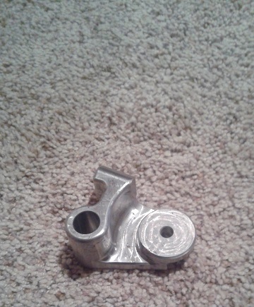

Got some more parts in the mail. My ARP main studs showed up. Also got a billet timing tensioner from Boostwerx (Dave H) for a steal!

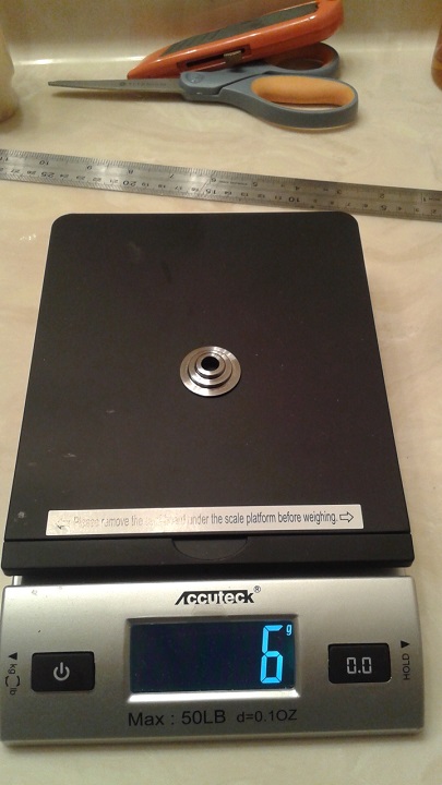

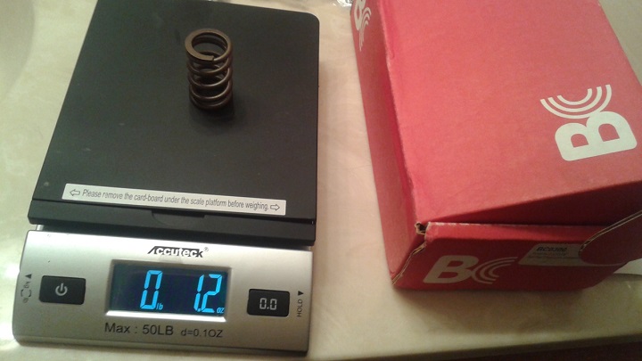

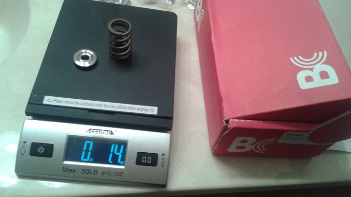

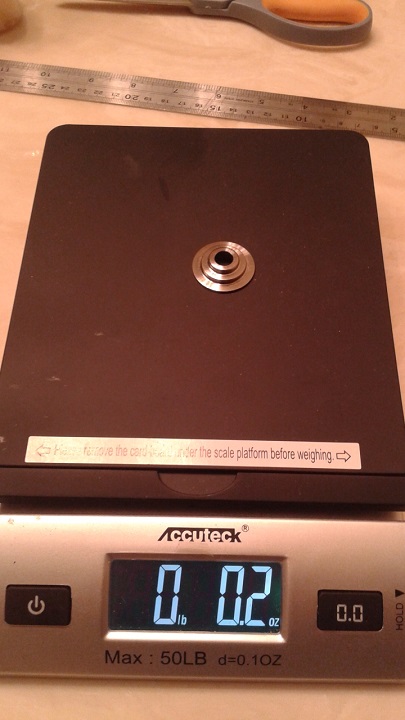

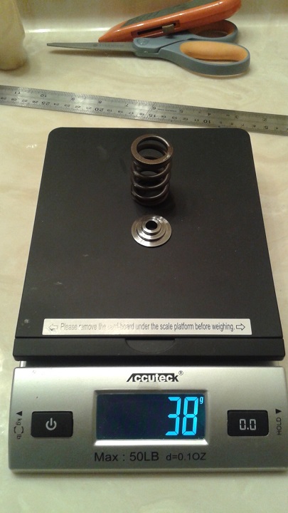

Small updates, and also just a few notes for myself.
I had gotten such a good deal on those BC single springs / retainers. But I stumbled across someone selling a Manley single springs / retainers / locks setup. Not that I feel the BC's wouldn't work, but in general I just feel a lot better about the Manley brand. I had thrown Manley a few emails regarding my pistons and rods, and they were very quick to reply, extremely helpful and friendly, and detailed. And when I found these Manley springs for sale I asked them about them and again awesome customer service. For comparison I have sent a couple messages to BC (about cams actually), one of which I've never gotten a reply to, a different later one I did get a nice friendly reply to that time. To me the Manley support was much better and was something I appreciated. So, I threw an offer on the Manley springs similar to what I had paid for the BC's figuring well if I can get them for the same price then hell yeah, and if not no big deal I'll run the BC's. They accepted the offer. They are very similar specs, however the Manley are just a hair stiffer, and also includes new locks (BC you retain your stock ones). The slightly stronger seat pressure I think I will appreciate if I ever do try to run north of say 35psi.
So I threw my BC's up for sale, sold within a day for more than I bought them for which was great Amazing the deals you can find if you watch for people selling off their stuff for their 'planned build' and their circumstances changed. So anyway I'll be running Manley Springs / Retainers / Locks now. Not that it actually means anything, but I like the fact that I have all matching Manley stuff now (Rods, Pistons, Springs), just makes me feel like things are a nice match instead of a mixture from x, y, z. If only they sold some cams, lol.

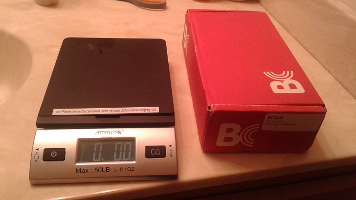

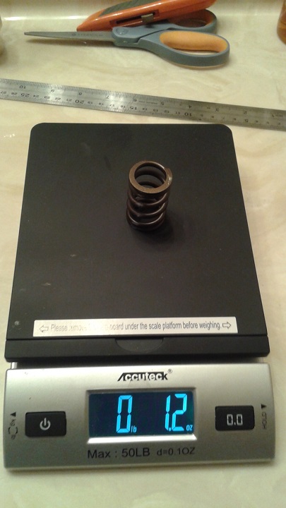

Before I sent the BC's away, I put a spring and retainer on my little scale just for curiosity. Then I just put a Manley set on the scale too. Kinda bummed because I measured the BC stuff in Ounces (didn't realize I could select grams), which isn't really as granular as grams. When weighing the Manley, I realized Grams was an option. Just kind of wanted to see how different they weighed. I'll be weighing a stock setup too once they're out. But anyway, here's the values I got for them. Oz they are a dead match, if I would have measured the BC's in grams, maybe I would have seen a tiny difference but none-the-less pretty much identical weights. Once I get the head-work started, I'm going to measure a stock set for comparison sake.
BC
Seat @ 1.325"= 80lbs; Open @ 0.980"= 158lbs
Retainer 0.2oz
Spring 1.2oz
Total 1.4oz
Manley
Seat @ 1.325"= 82lbs; Open @ 0.985" @ 165lbs; 0.895 @ 187lbs
Retainer 0.2oz / 6g
Spring 1.2oz / 32g
Total 1.4oz / 38g
