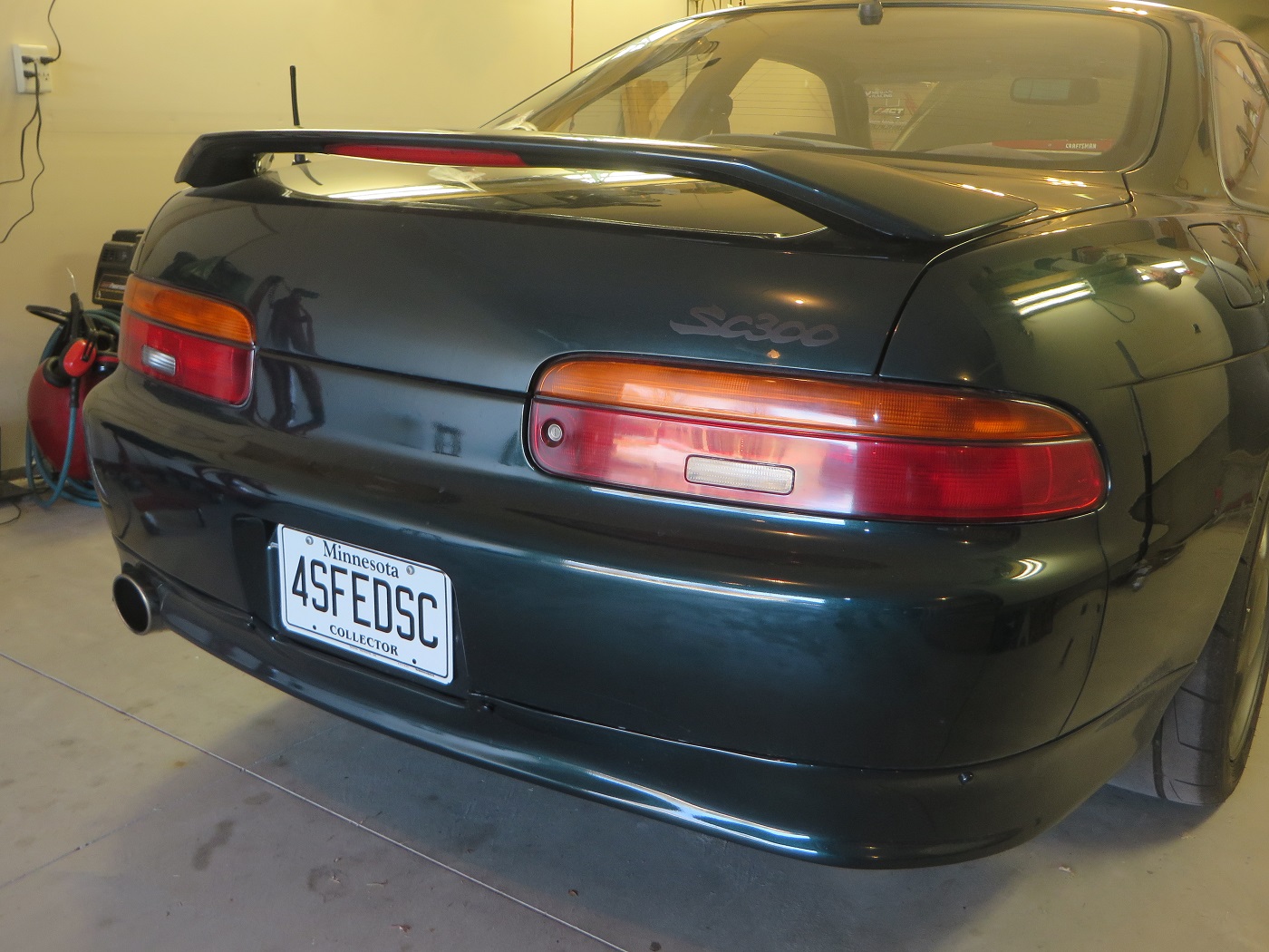

DMV sent me a present today Custom Collector plates. No more annual renewal, no more front plate!

Looks good, I love the color of the car.
Old 03-15-2017   #1471
Re: Project Lex
^ I have to say, the color has actually grown on me a ton lately. So many neutral colored cars (White, Black, Grey's), I'm really glad it has color. And I've started to notice I love this dark metallic green now. I wasn't a huge fan originally. I really love the Supra's in the same color. Probably my favorite color Supra honestly right now.
Old 03-15-2017   #1472
Re: Project Lex
I love dark metallic green in general, i think it really suits this car.

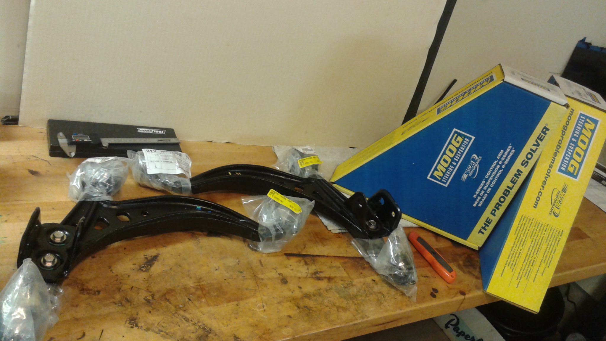

Gotta love unplanned expenses. New OEM Supra front lower control arms. And new Moog front upper control arms. Should help it ride better and let me get the front aligned better now.
