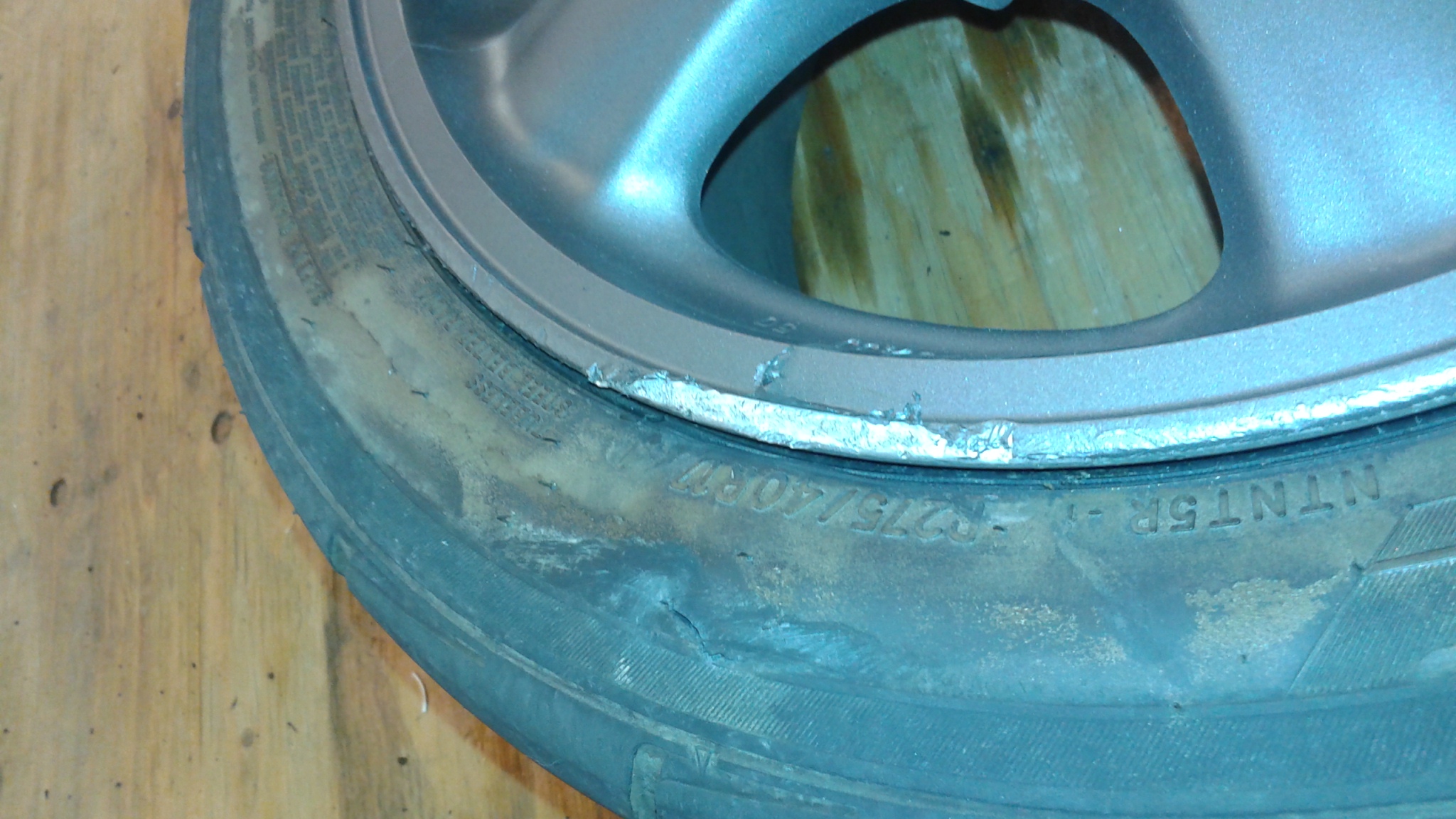

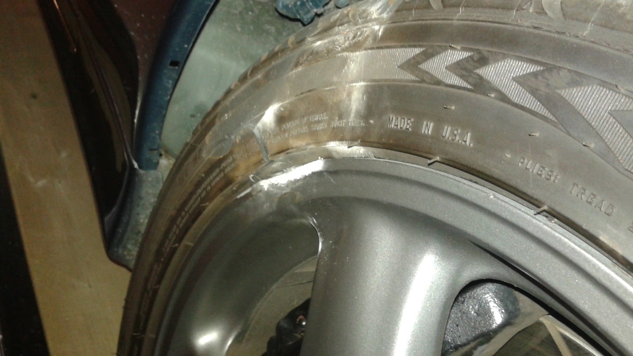

Had our spring opener meet this Sunday. *Was a little cold out, very slight occasional mist but not bad overall. *Got a couple nice shots of the car:
Then leaving the meet, in 2nd I gave it a little too much and got a little sideways and hit the damn curb. *Feel like an idiot. *Drag radials, cold weather, slight mist, and me still getting used to the power it has = dumb mistake. *So my wheel is hurt and i popped a tire. *Also the fans had shut off for whatever reason so while we let it sit and idle coolant started coming out of the overflow. *That's when we realised the fans didn't turn on. *Shut off the car, the BTI gauge showed 219* when I finally looked at it. *So... *Now gotta figure out what to do about wheels, and going to investigate the coolant issue, hoping I didn't pop the head gasket. *I've post-poned my dyno appt so I can take my time and make sure everything is OK before I stap her on. *Sucks, but could be worse. *Doing my best to get back on the horse here and fix it and keep moving forward. *I figure it could be worse, it's not like it caught fire the day before trying for 6's at TX2K right? *I'll be fine, and I'll get it fixed, not so bad really.

Yeah I wanna be sure the car is 100% before the dyno, so just playing it cautious right now. Gunna spend the next few days slowly going over it to make sure everything is ok.
So if anyone knows a local place that can repair curb damaged wheels, please let me know!

Well I left a voicemail with Alloy Wheel Repair in Shoreview. I also called and spoke to a guy at Twin City Wheel in White Bear. So we will see what these folks have to say once they see the photos. Hoping they can be repaired. If not, then I guess I gotta start thinking about what to do with wheels.
Yes I agree that temp seems like it shouldn't be a big deal. But at the same time, coolant was coming out of the overflow. So why would coolant be coming out of the overflow. Not just like a few drops, like a decent amount came bubbling out. So that's why I'm a little concerned there. Why would it do that? Is 220-ish hot enough for coolant to come out? Or maybe I cracked the radiator, system lost pressure, and caused coolant to start coming out places. Not sure yet, have to look into that.

What position wheel is that? I assume the front so that you still can replace the control arms and hopefully not have any bent suspension parts?

Passenger side, front and rear wheels. Front one is worse, and is the 2nd picture. First pic is of the rear. I looked under there briefly, didn't notice anything bad, but something I'll be looking at for sure as I get to looking closer. Good news is I have all new front arms that I'll be installing none-the-less lol.
Good news is local place in White Bear said they can repair the wheels. $100/ea to repair (not including coating). Typically 1 day turn around. So I'll be getting those over to them in the next day or two. Seemed like a fair price and an excellent turn around time.
