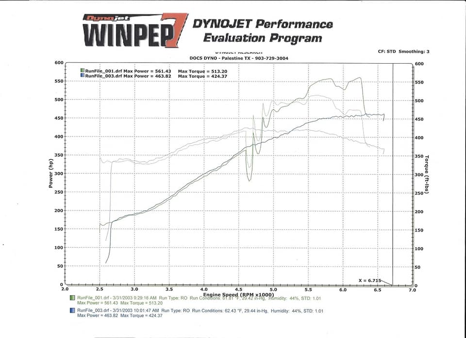

Put it on the dyno, Made 463/424 N/A.
Hit it quick with a 100 shot, 561; had issues with the boost a pump (fixed now) so the power cycled as the nitrous nannies turned it on and off.
Attached some graphs showing the new power curve. Old NA vs new NA (fast 102 helped) and the nitrous graph and associated log showing the solenoids cycling. I figure the geeks on here would like that data.
Been busy building a barn so the car has just been sitting in the garage waiting for me to have time to drive it.

Name:	MAX FAST 102 graph.jpg
ID:	17395   Click image for larger version
Name:	nitrous graph.jpg
ID:	17396   Click image for larger version
Name:	nitrous vs na graph.jpg
Name:	fast versus dorman.jpg
