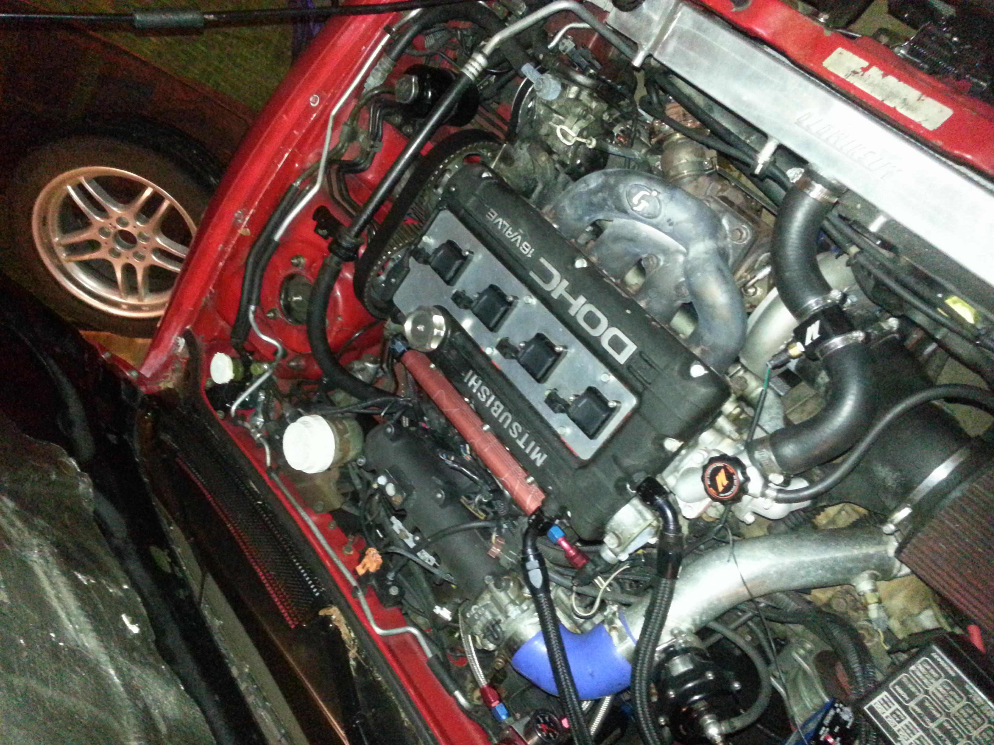

Spent some time working on the car on saturday. Got the side skirts installed on both sides. Wish the previous owner hadn't tried doing it. As the passengerside came out perfect. And i had to re drill location of a hole on the driverside. But they are on.
I also replaced my oil feed line with a new one as well as the fittings.
I ordered a new 02 sensor but didnt install it. The aem wideband is being replaced so I didnt want to wait and have it be discontinued if it turned out my sensor was bad.
I cleared up every oil leak but 1. And its coming from the oil filter housing.
Never worked on that before but I know there is a gasket there. So will order that when I do my oil pan upgrade.

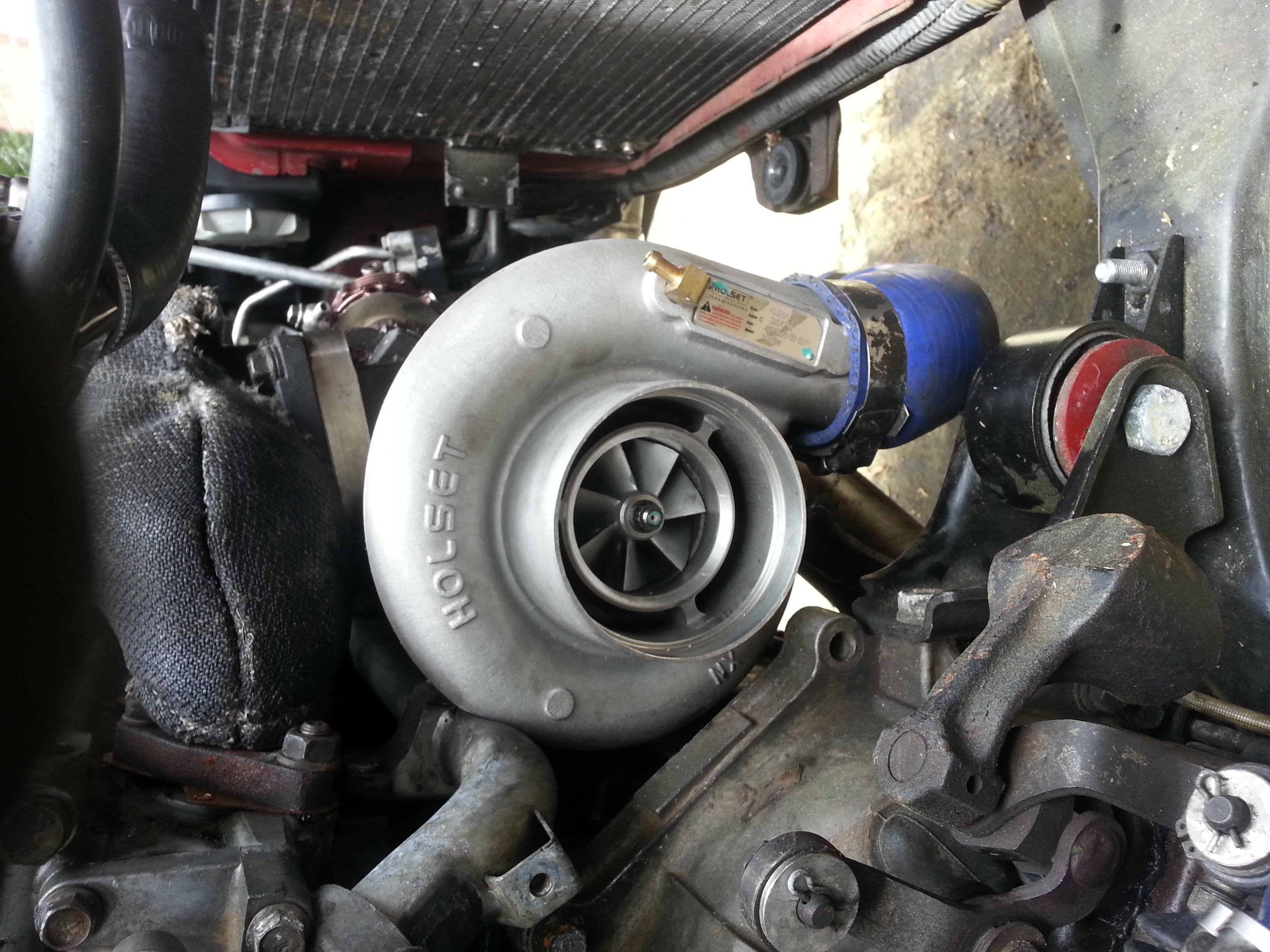

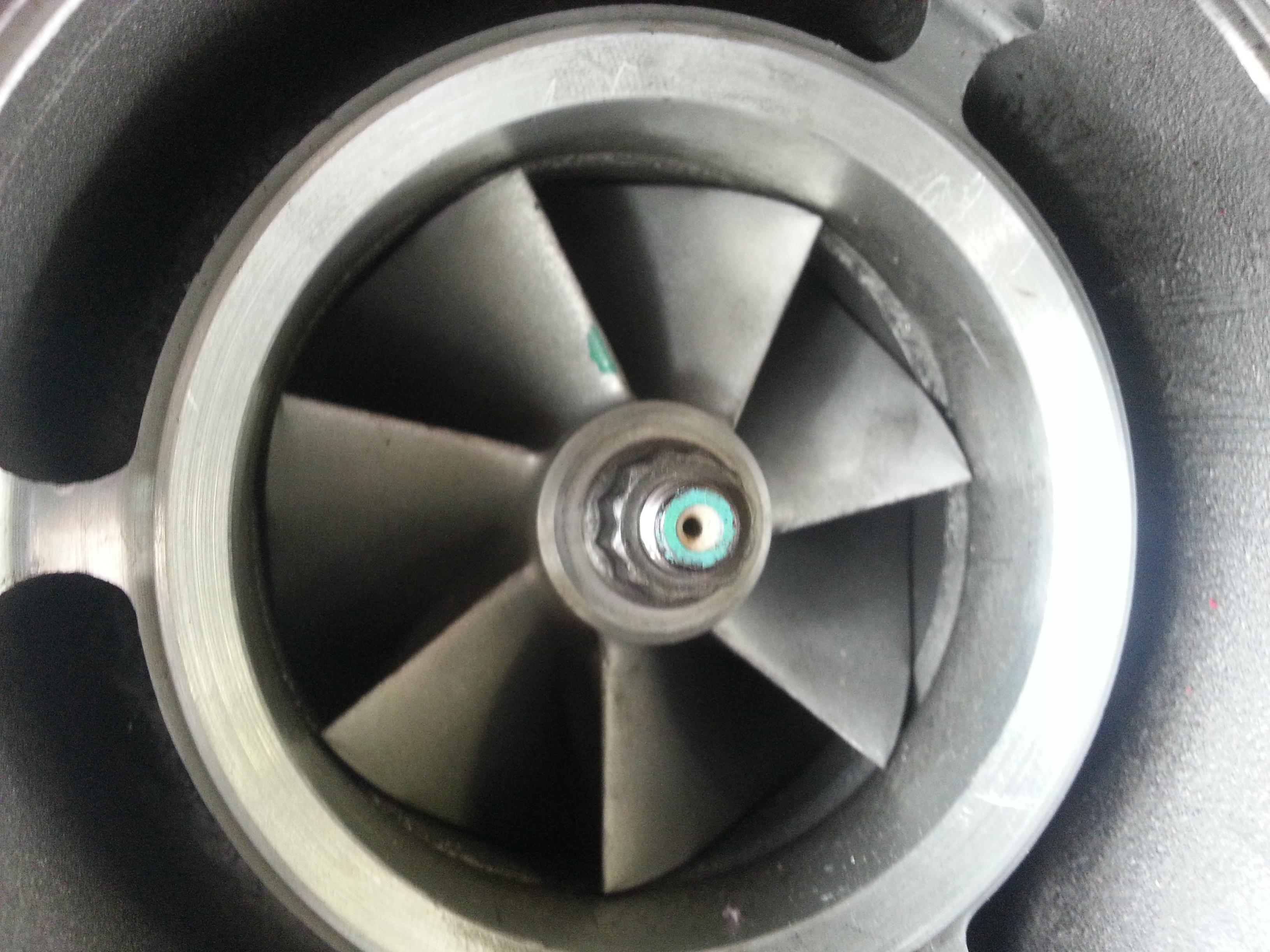

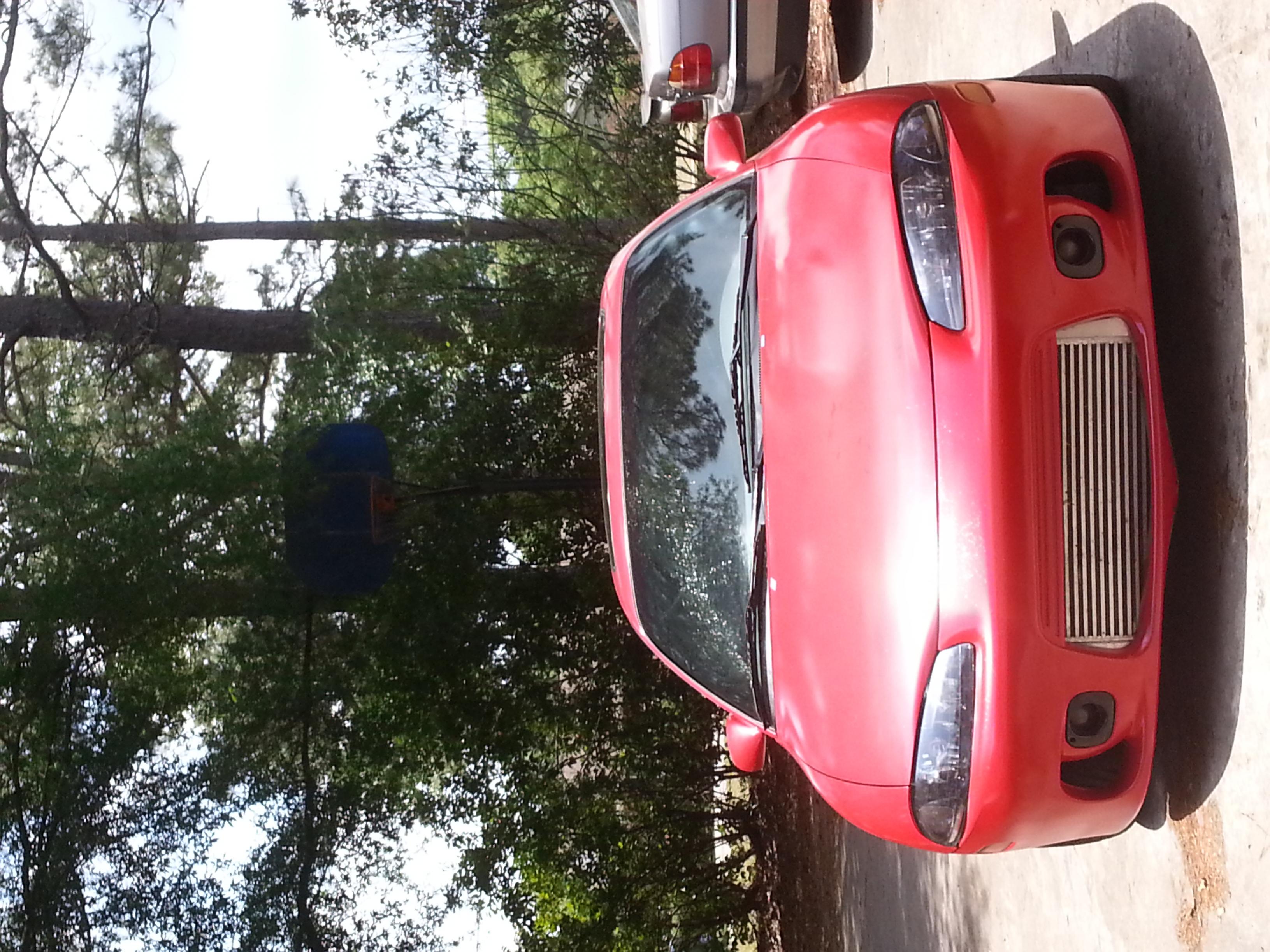

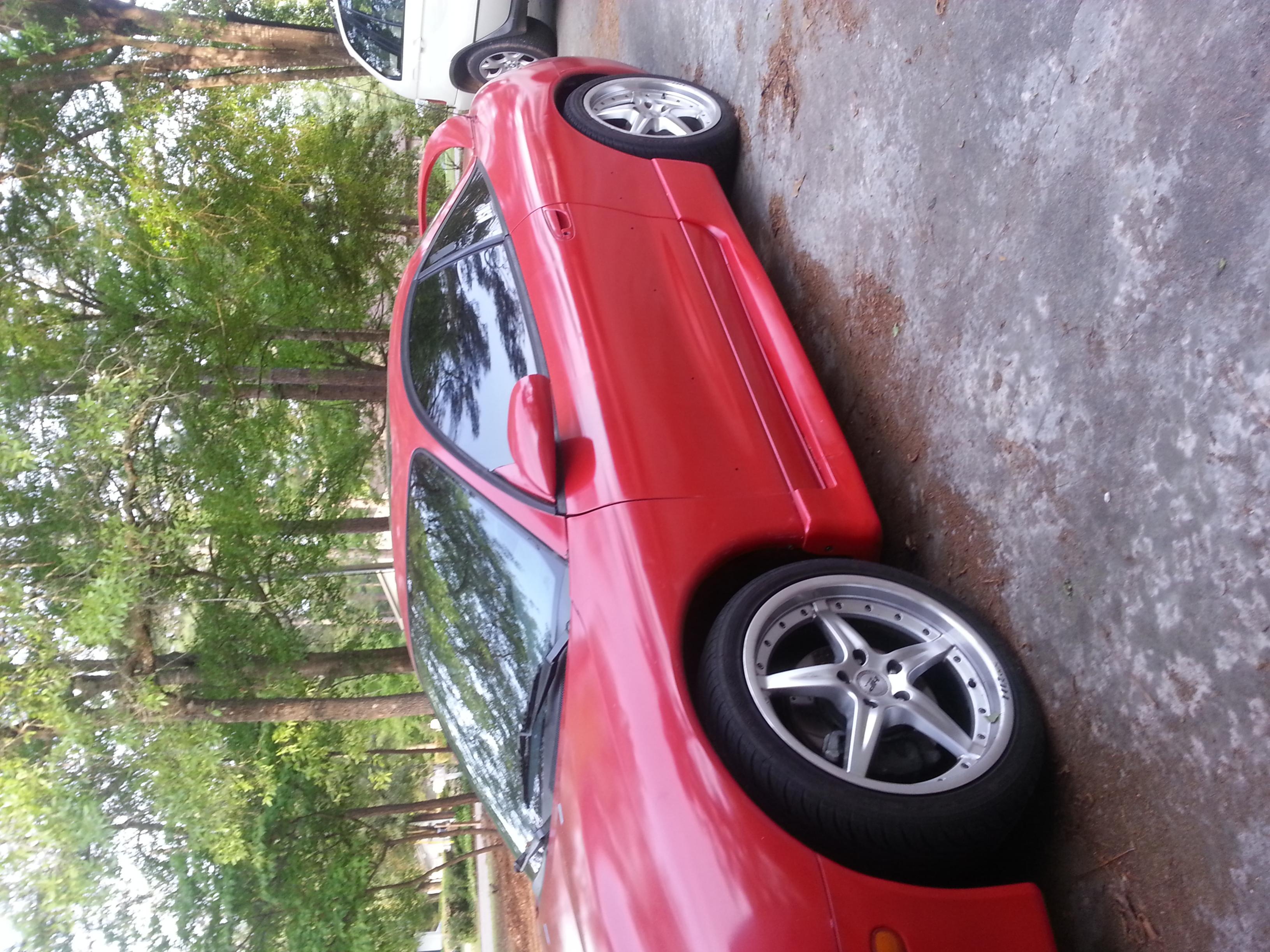

I uploaded picts of the side skirts above , im on the fence about adding the lower door pieces kind of like it like this.
I also just realized I hadn't loaded any picts of the hx40 installed do here ya go. Also threw in a fun shot of car looking like a rwd launch

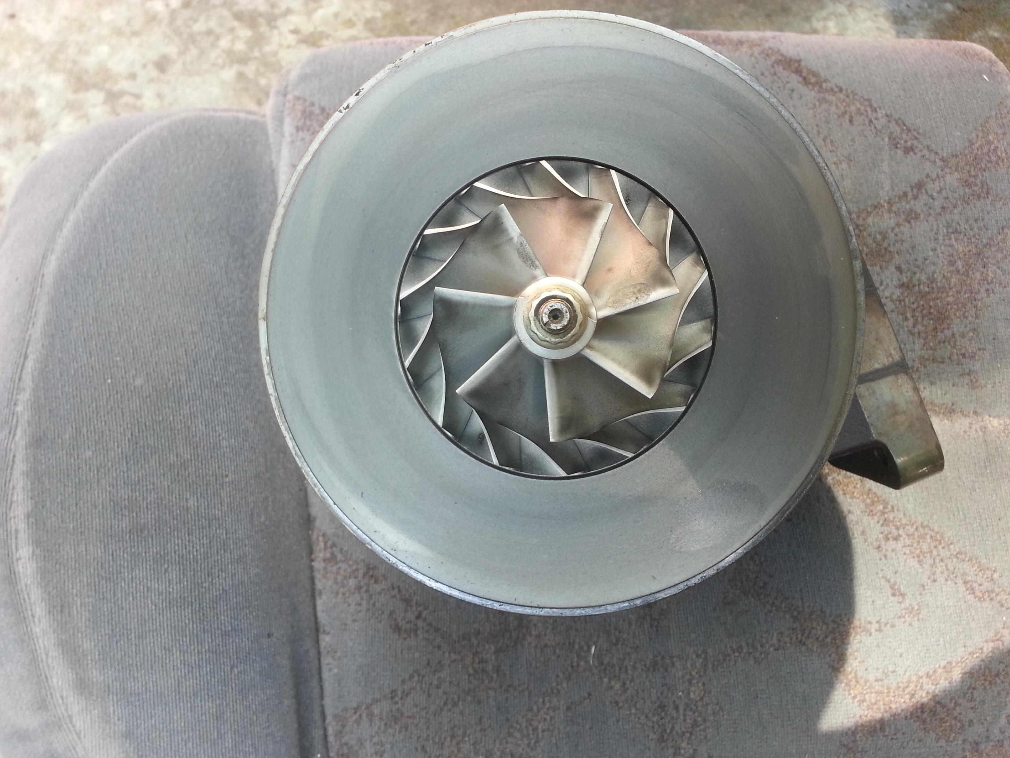

Fog light covers installed, side skirts, hx35 compressor wheel, and new 300m coils installed

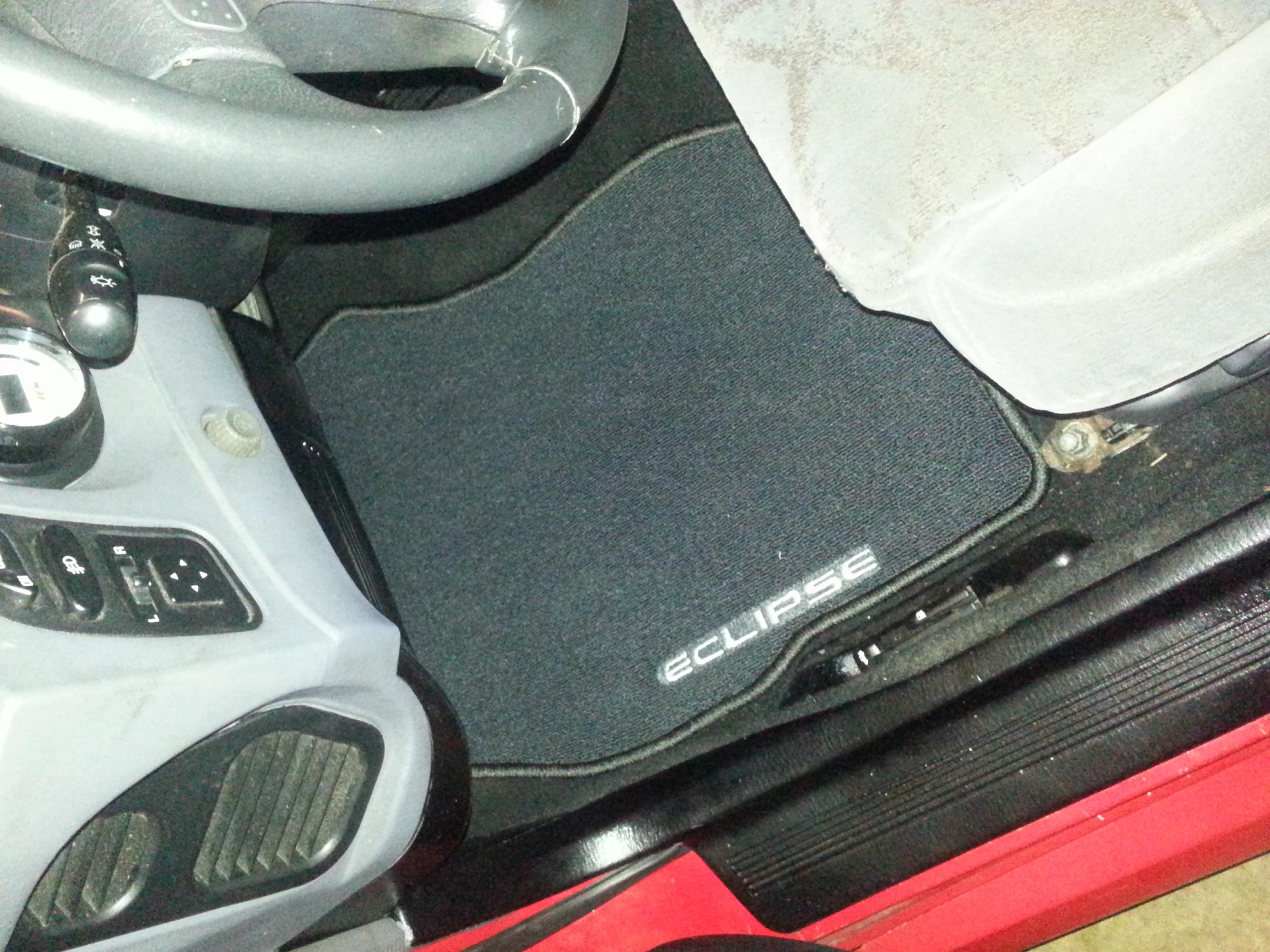

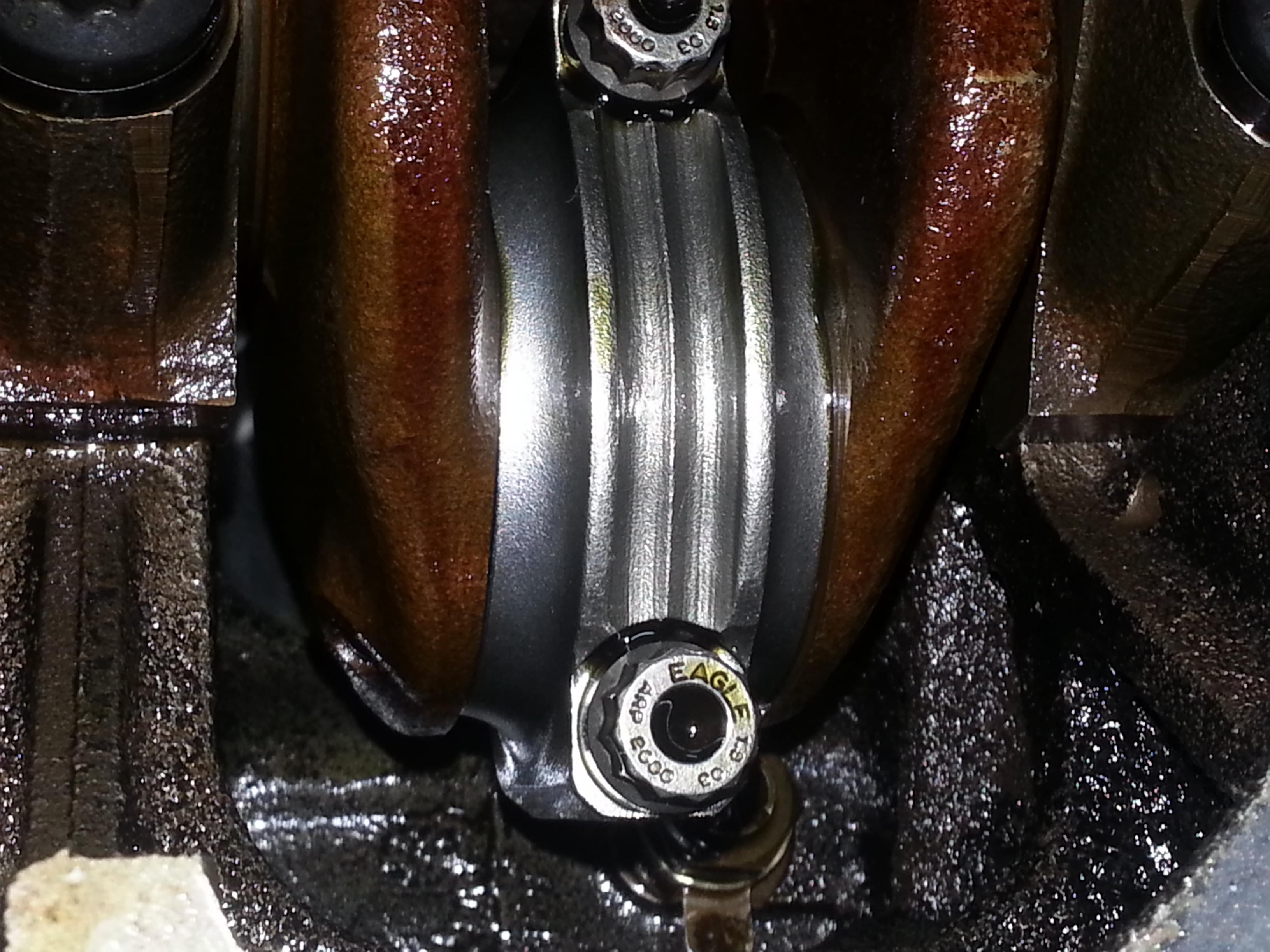

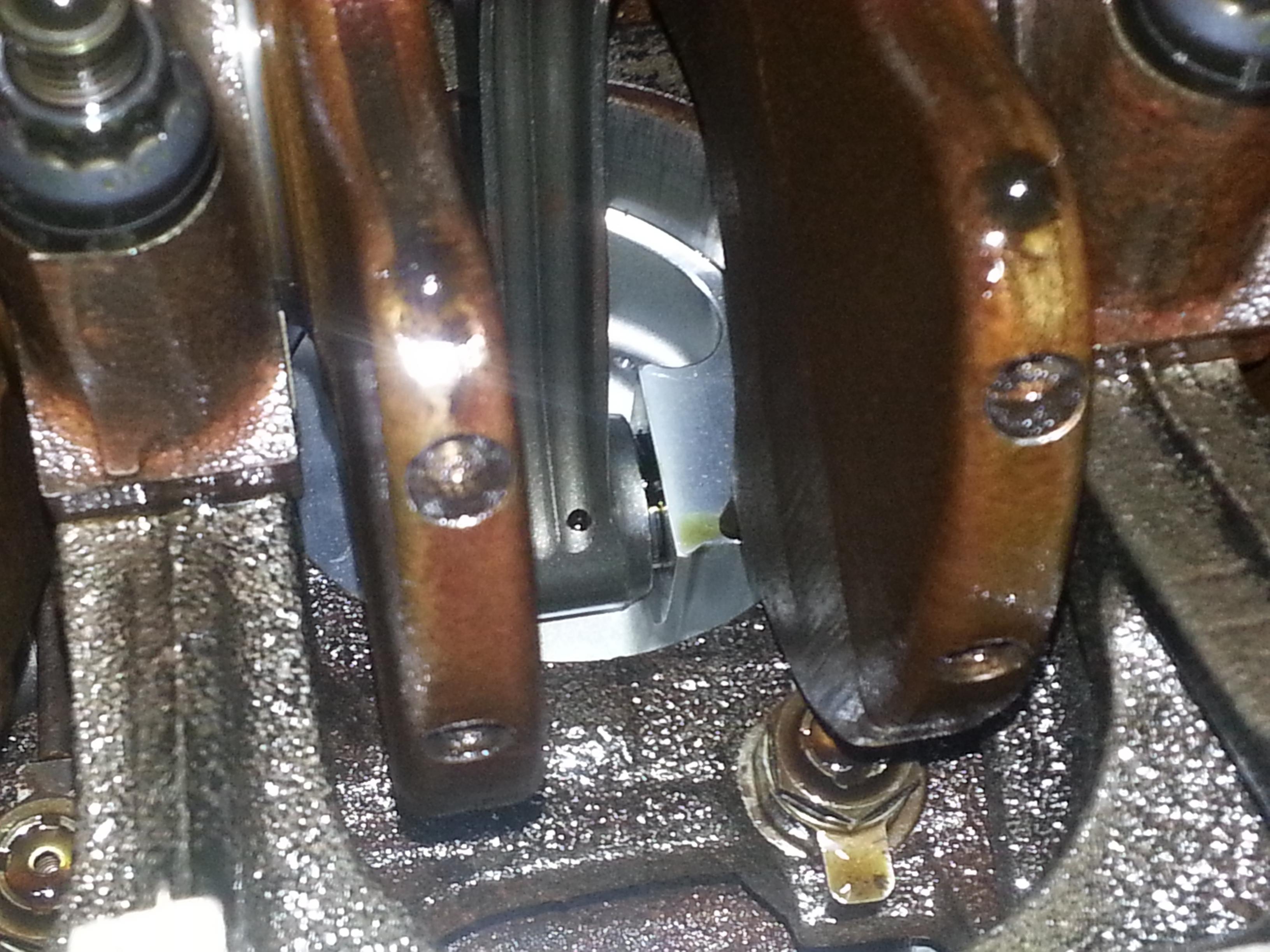

Old 05-20-2015   #168
Well while I had the oil pan off i wanted to verify internals. Everything looks good.
I also put in the new oem floor mats.
