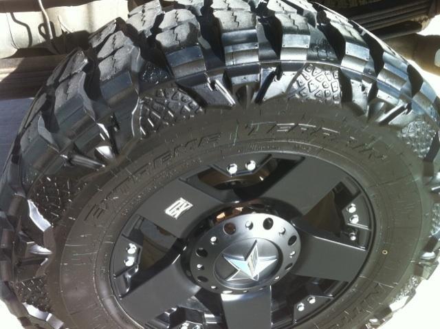

Re: programer for a gas truck?
meeeeatty tires
