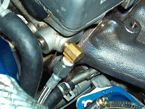

Re: big 16g: noob question
Here is a picture. It is recommended to feed most all journal bearing turbo's from the head as the excessive oil pressure coming from the oil filter housing can cause oil to leak by the seals and cause your car to smoke. You can just use a banjo bolt where the allen headed plug is. No need to retap the head.
