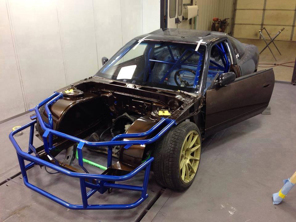

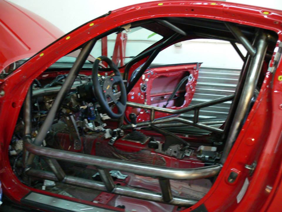

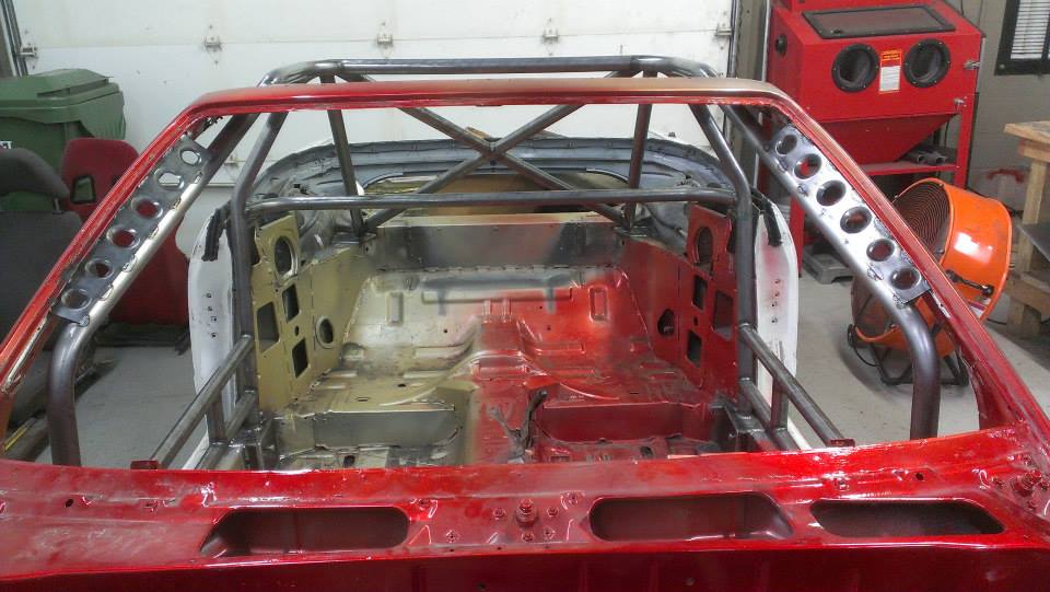

Patience metal fab seems to be big into tubular stuff as well and they can get certifired.
I have talked to these guys (turns out the be the company that did MAP's sponsored drift 240sx) and I really like what they do. I'll check in with them when they are open. Racecraft thought I was nuts, and I'm waiting on a reply from Vassil. Worst case I just go tubular front end with new strut towers front, and have Patience do a new floor pan along with a roll cage connected to the rear strut towers.

I also contacted the fab team that did the green 240 drift car at MAP's show and he estimated roughly 6K give or take for taking the shell and adding in a tubular skeleton throughout allowing all the stock stamped metal to still serve as mounts and shaping, yet have the rigidity needed to not worry about strut rust, floor pan damage/repair, etc. The issue I felt with going with that option was simply the feeling that cars or at least street cars weren't their biggest markey/forte along with a long time frame which didn't bother me however.
Are you sure he wasn't just quoting you on a tubular front suspension/structure and/or roll cage? That seems awfully cheap. You do realize that once you remove the unibody, you have little to no positional references right? This is a massive undertaking to do it right and get all the pickup points dimensionally the same.
If all you want is something rust free, just find another pristine running/driving DSM from down south or something. It will cost you less and be far less hassle and you'll get what you're expecting.
