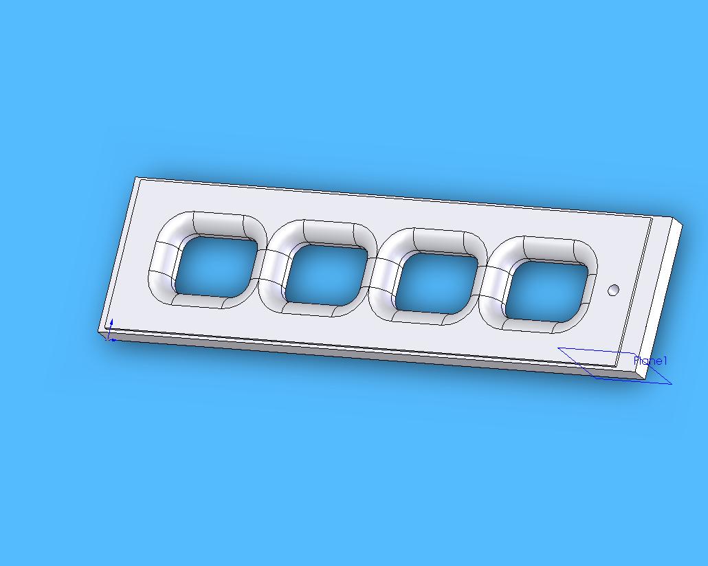

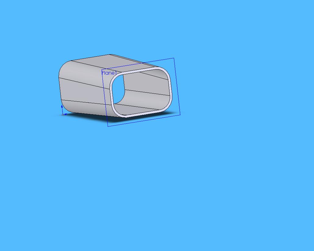

I didn't put the whole assembly together, but here are some screen shots of a few of the pieces. The runner and then the bottom of the plenum that connects to the runners.

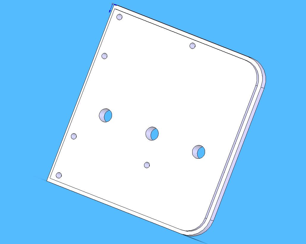

Here is one of the cool things that I include on my manifold that noone else has. Coil mounts! The L shaped sets of holes are to mount each coil. The wires will point straight towards the engine. There are also 3 vacuum ports on that end, they have enough room between them to use a 90 elbow, so the lines will be nice and clean. There is also a vacuum port built into the top picture to supply the BOV. It is closer to the BOV up there to make it react faster and keep the engine bay cleaner, because of the shorter hose.
All of the pieces have a milled out edge like this so it all goes together like a jig-saw puzzle. It also allows for a better weld.

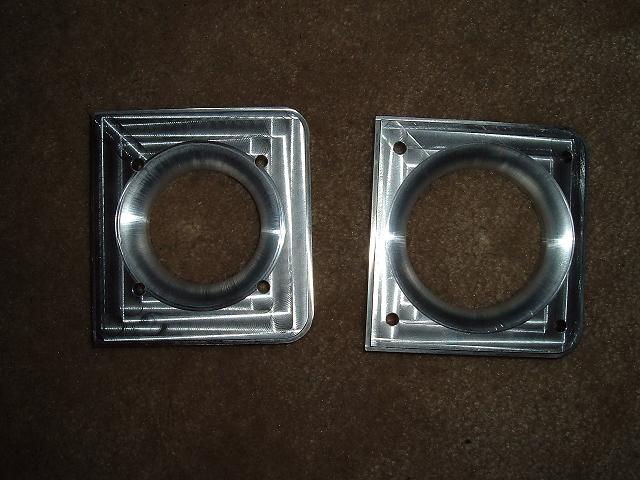

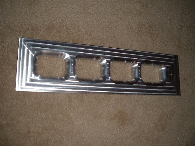

Here are some of the pieces in real life! This is the 2 different throttle body flanges and the base of the plenum that attaches to the runners. The machinist did an awesome job!

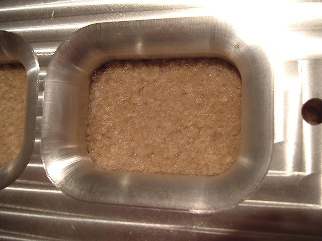

correct me if im wrong, but why does it seem like there is an excess amount of chatter? Was he milling too fast? Or did he just kinda get it done because its prototype? Or does it just look that way! ( thats very possible)

Are you talking about inside the radius? The flash really makes that show up. Looking at the part, it is very smooth. I updated the picture with one that didn't have the flash. The pic is also larger than real life, so remember that.

Dont get me wrong, that looks extremly nice. i know how hard it is to run a CNC and get exactly what you want out of the deal. Most people think its just punching some buttons. its really Lots of math, thought, planning, and specing.
The reason I asked was because i think it was there, and I thought it might effect the way it operates. On the other hand, it may effect nothing.

You can't even feel any chatter with your finger. It is just the camera making it stand out. These are also the first prototype parts, straight off the mill. All production parts will be polished before they are assembled, so if anything like what you are thinking is present, it will be taken care of. We are making a few changes to the production parts too.
